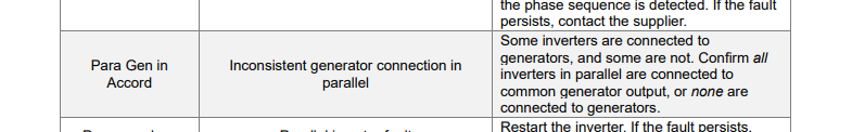

After putting the generator in Auto mode and turning the Main Breaker On, all 3 inverters have the fault "Para Gen unAccord”
and power to the home stopped.

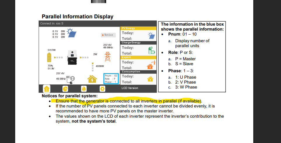

You said your generator is connected to the main inverter.  I believe the generator needs to be connected to each inverter when the inverters are in parallel ... from the manual (1 sentence about it!!)
This is from the 12000XP manual "NOTE:
When connecting multiple inverters in parallel, the generator must connect to
each inverter. Connecting to a single inverter in a multiple inverter
configuration is not supported."

yes I just was told that by the EG4 tech-support who finally after a week called me back.
it seems like that needs to be made more clear in the manual.Thank you

That is correct. I just want to confirm for anyone that comes across this thread.
when multiple inverters are connected in parallel, the generator must be connected to each inverter in that paralleled system.
