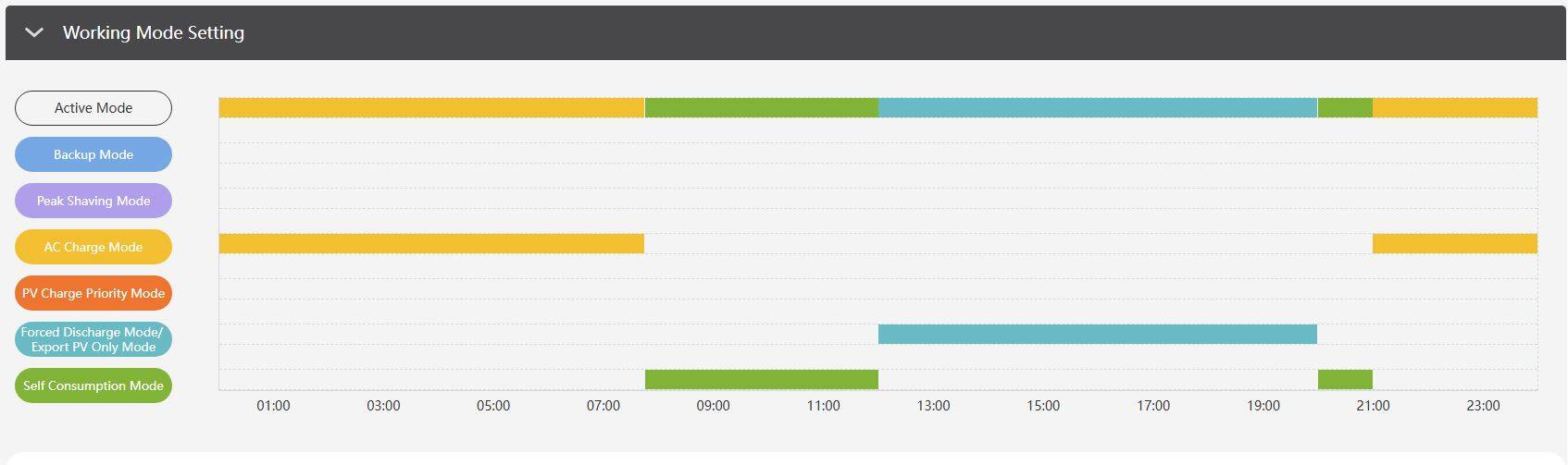

I have a new installation (Gridboss, Single Flexboss21, Single EG4 powerpro battery and an AC Coupled PV system).  I believe I have it setup to make full use of my utilities TOU program where I am AC Charge (trickle charging) the batteries overnight and then run Self Consumption for part of the day and force discharge at the end of the Peak TOU period to sellback all my stored power at the best rate and make sure I get my full recommended 80% discharge on the batteries.

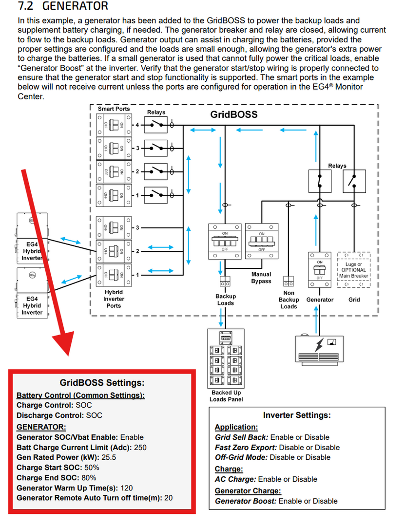

As long as the generator settings are configured with the correct start and stop SOC values, the FlexBoss will automatically switch to using the generator to charge the battery when grid is down.

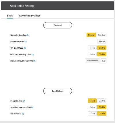

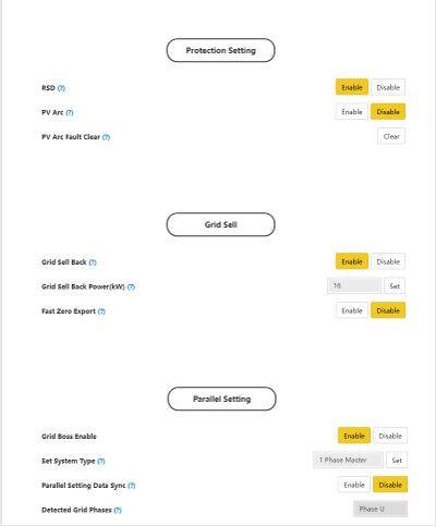

Yes I have Grid Sellback enabled.  I am also using the weekly mode feature of my inverter, if this makes a difference but it is similar to the "working mode" settings in the attached screen shot.  Thanks!

Thanks Eric, but I'm still having an issue with this.  My "Existing AC Coupled System" is connected to SP1.  When the system first went in and the grid was disconnected, AC CP and SP1 would stay on and the flexboss would charge the batteries from solar.  Now that there is generator is installed/enabled and I have my approval to operate from utility... AC CP switches "off" immediately when the grid is down.  Could this be a configuration setting or is that just the way it's supposed to work when you are grid tied and are set to sell back?
I would ideally like it, when the grid is off and battery level is above my generator SOC setting that the system run off of solar verses running off of battery.
