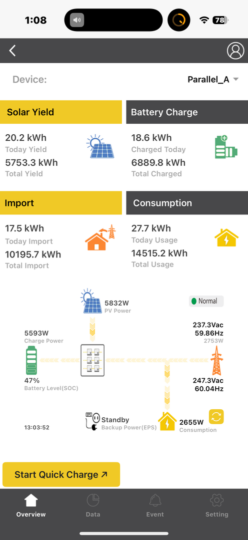

In the eg4 monitor app for iOS there are two voltages shown on the grid side, both are around 240v, why are there 2 voltages?
IMG 0854

It appears to only do the separate voltages when I have both inverters running in parallel ( I have a Denali EV and a 19kw charger, when not charging my truck I turn one inverter off). Is it the voltage in for each inverter? Why would the voyages be different?

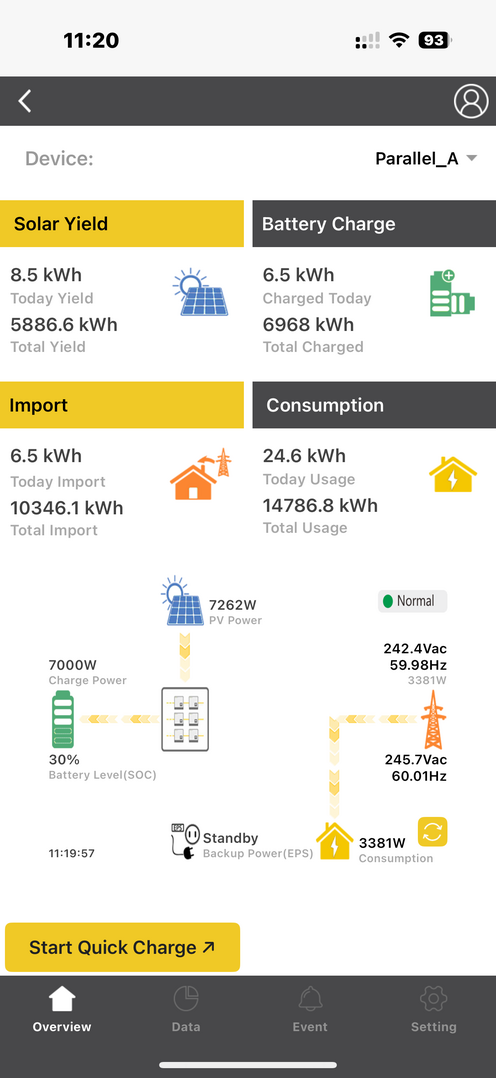

IMG 0862
 here's another screenshot from this morning, both inverters on and different grid voltages and HZ. Doesn't make sense.
Posts: 1294
Thank you for sharing that!
It appears to be a small bug. I'm not exactly sure what the other voltage represents. It seems like it could be each inverter's grid voltage, but I can't confirm that.
