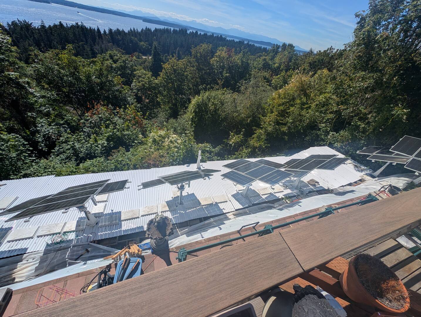

I purchased the EG4 12kPV hybrid inverter a year ago as I began building a DIY solar system around 8 Eco-Worthy solar trackers. Since the trackers are on a steep slope, most of the effort has gone into what I think of as infrastructure (see accompanying picture). I am now wrapping up the overall project and need help bringing the inverter online and getting approval for grid connection with Seattle City Light.
