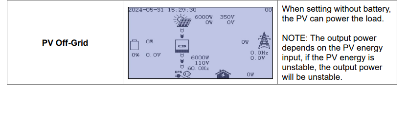

You can operate the inverter without battery.
If the system isn't turned on properly with the battery, it can be damaged. I'll attach the link of the startup and shut down process.
If the inverter turns on with the PV, that will indicate that the battery terminals on the inverter are damaged.
