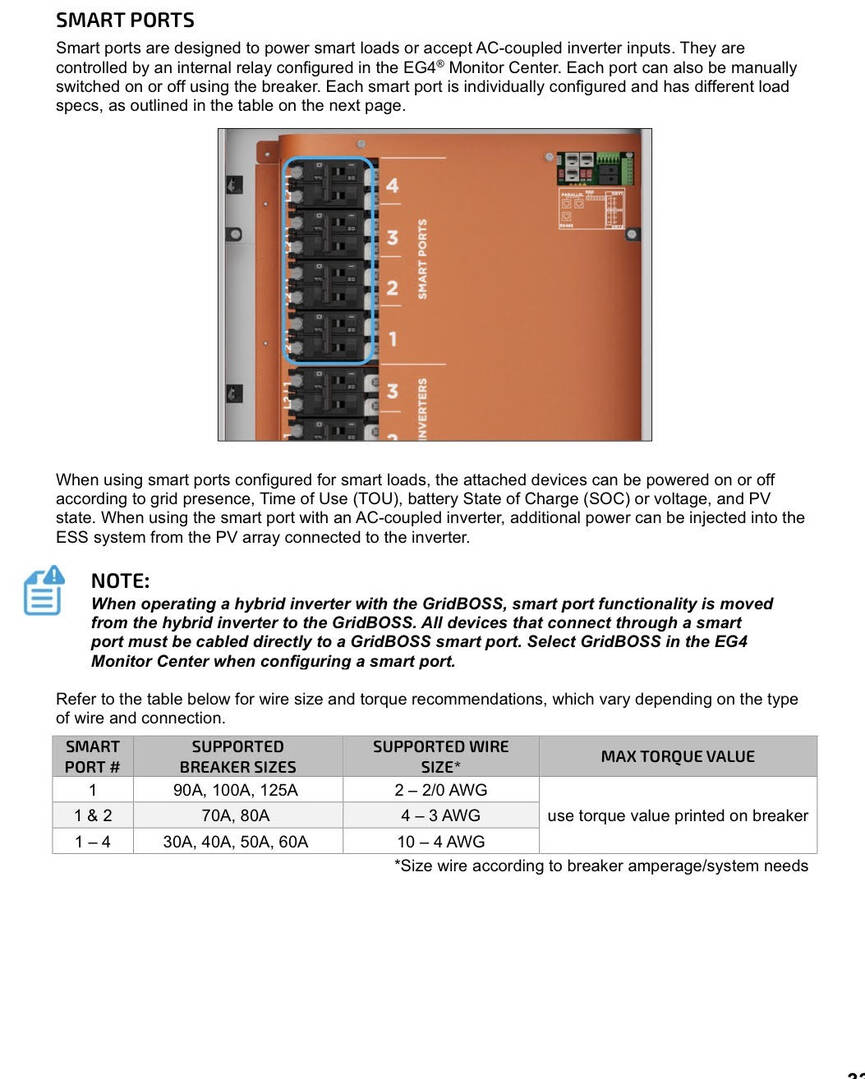

As a follow up on this.....I would like to point out that it "may" be possible to use other inverters (not just EG4) with the Gridboss.
The generator INPUT accepts any 240v pure sine wave source to power and charge your batteries.
Look at the 12 minute mark here -
In theory any device (inverter / generator / etc.) that can supply pure power into the Gridboss can be coupled through the Generator port.... and possibly through the Hybrid Smart Ports as well.
unnamed
It may not be the INTENDED use but it will work.
