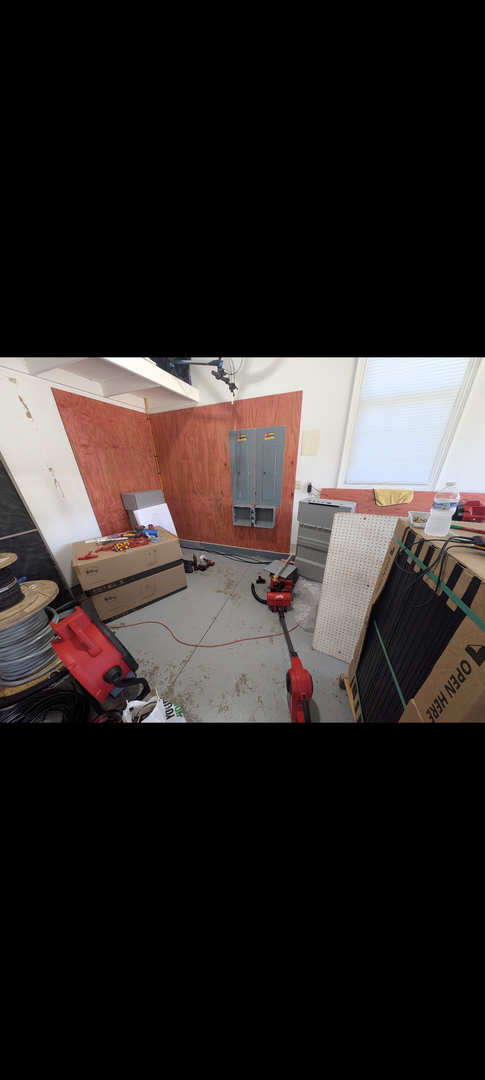

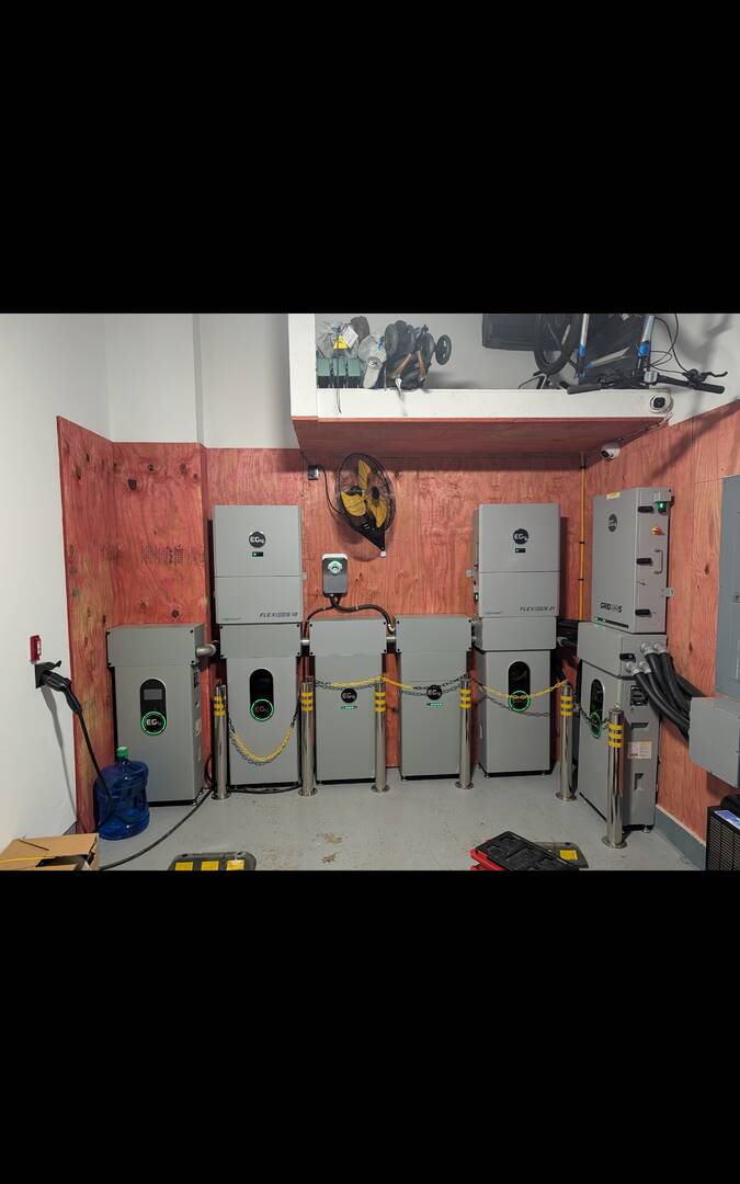

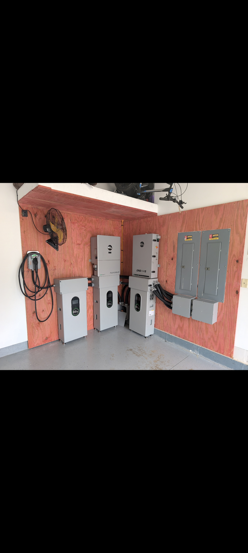

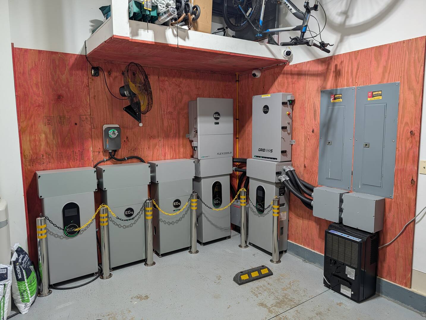

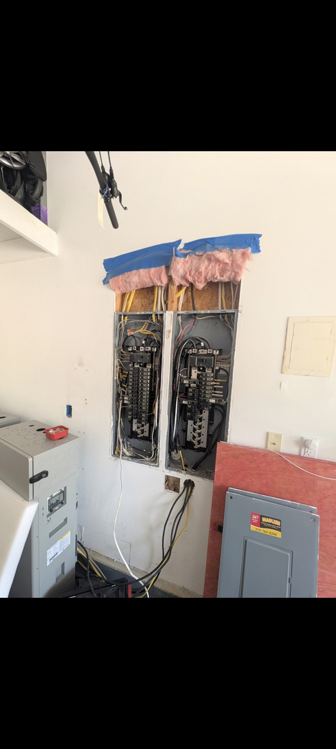

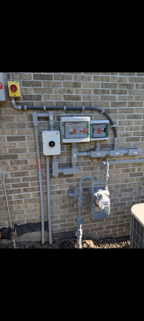

Hello new to posting on here. After about 5 months I finally got my system fully running and complete. I have it grid peaking during the day, forced discharge at prime time.I sell back all solar and then charge everything at night on Super off peak. I have 2-200 amp panels that had to be completely redone as the house was split so I had to move the house to 1 entire panel. 2 car chargers, and 100 A sub panel are on the 1 Main panel feed directly off grid. The main incoming gas line to the house from the meter had to be rerouted and a few romex cables as well had to be rerouted. The grid boss now feeds it's now Sub panel that completely feeds the house. I have a circuit built for if the Grid goes down it kills a relay to then take the AC unit off line so it doesn't  just sit and chew through batteries in the summer during a extended outage. As it is a 5 ton unit. I put a soft start on the AC to ease the start load and the flex boss does a great job. I Live in Northwest Indiana not ideal for solar.

Actually added to the system a bit more!
Screenshot 20260310 200902 Photos
Posts: 1285
@cptmorgemaker
Nice! Looks good!
