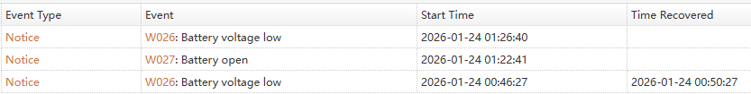

I just switched over to an EG4 18Kpv from a new Growatt SPH10000 that had issues.  Prior to that I had an off grid setup for 17 years around the Outback VFX3648 inverter with Outback charge controllers, the HUB, the FNDC, and the MATE3. My Outback set up worked well, but was well undersized from my needs for the past 10 years.   Turns out the EG4 18Kpv has some issues and I hope to get those ironed out tomorrow with tech support.  For instance, this morning with snow overnight, the inverter shut down due to low voltage below my generator settings that were to prevent that.  I hope it has nothing to do with my battery bank of 7 SimpliPHI 3.8 52.1v M batteries because I do not want to buy new batteries to replace these that have only been in service for 2.5 years.   I do have the inverter set up for voltage instead of SoC.

I did get a NOTICE but had been monitoring the voltage so I knew why it shutdown.  The NOTICE cleared after the sun came up and the inverter restarted.

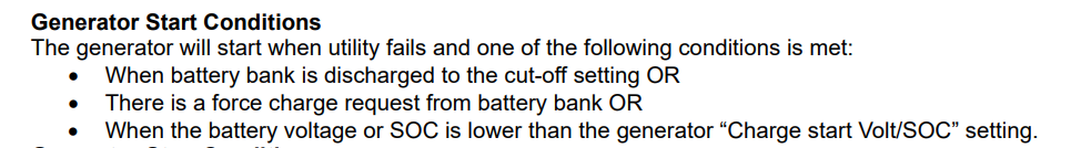

@eg4eric a couple of other things to add regarding the generator.  My installer was able to do the "Start GEN Exercise" using the button on the app yesterday.  Then today, I inadvertently turned the battery breaker off and immediately we lost power to the house and the generator started.  The generator ran for a one minute warm up and I heard a click, but it never started charging or supplying energy to the house loads.  Now, the voltage was above the Charge end voltage of 53.5v so that may have been the issue.  I switched the battery breaker back on and after about another minute the generator automatically shutdown.  I just need to know the generator will come on at the correct set point and charge the batteries/run loads.

@eg4eric, since I am completely off-grid,  I really need to find out if the generator will run based on voltage set points for the generator.  Do I do this by adjusting the generator charge start voltage within the range of the current battery voltage to see if it starts the generator and charges, or is there a better way?  Thanks.

Yes, you would need to set the Charge start Voltage setting. Once the battery goes lower that the set parameter, the generator will begin to charge the battery.
