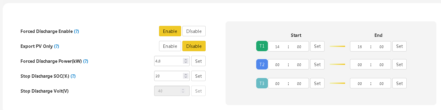

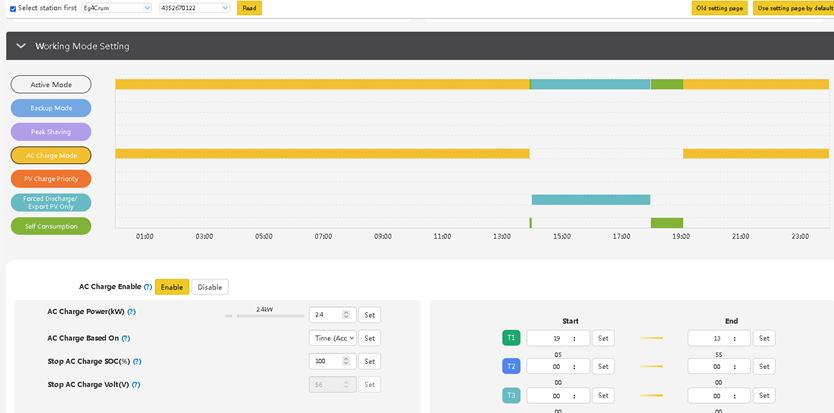

Are you able to post a screenshot of your current settings so I can try to identity what could be causing the issue?

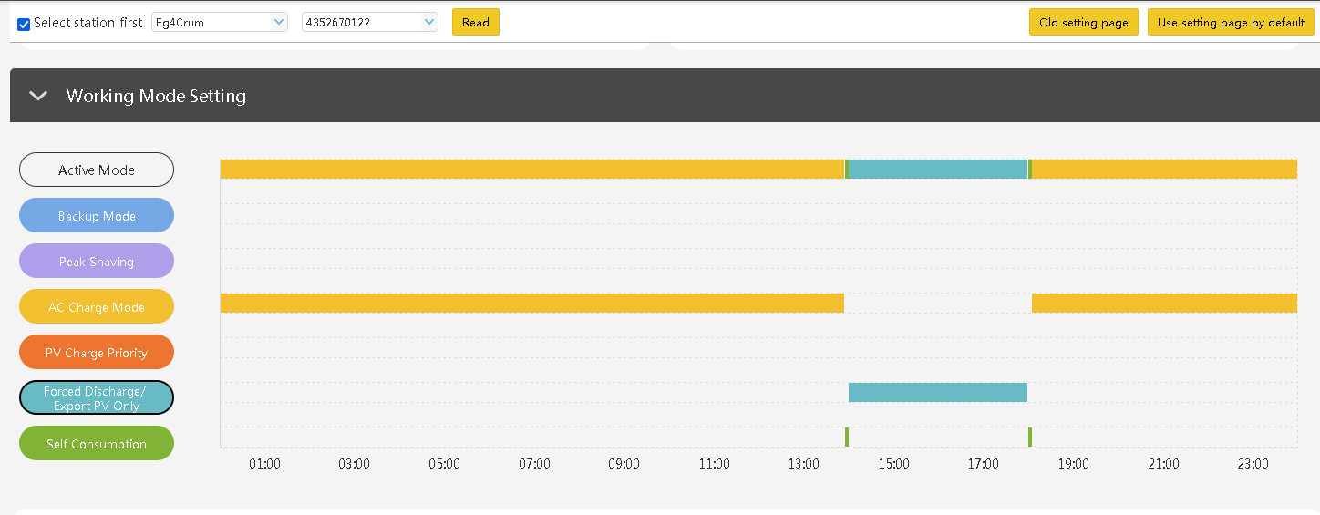

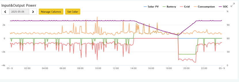

Here are a couple of screen shots.
Not sure how to make them bigger pic's.
Matt
Those settings look correct. Are you able to share screenshots of the old setting pages so I can look at all the settings? Or you can also share your station name with me, and I can look at it that way.

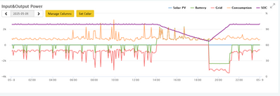

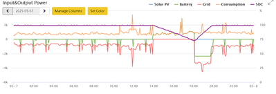

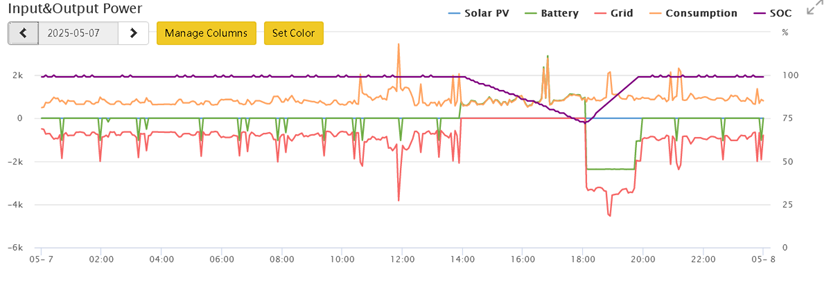

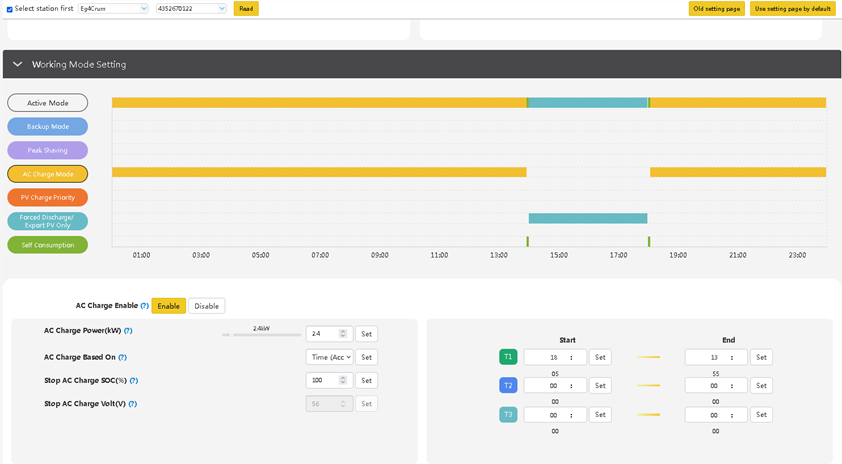

The first 2 screen shots show the Forced Discharge being contained be the AC Charge times.
The second 2 screen shots show that Forced Discharge again being contained by the AC Charge times, but the Forced Discharge end setting is not stopping the discharge.   In the second Working Mode Setting Graph it shows the Self Consumption time of 1 hour although the battery is still being discharged.
First 2
Second 2
Thanks,
Matt
The reason it’s not stopping the discharge is that the system is configured to use the battery before the grid. To change this, you can enable- Battery Backup mode, which prioritizes grid usage over the battery—unless you have Force Discharge times set, which in your case, you do.
