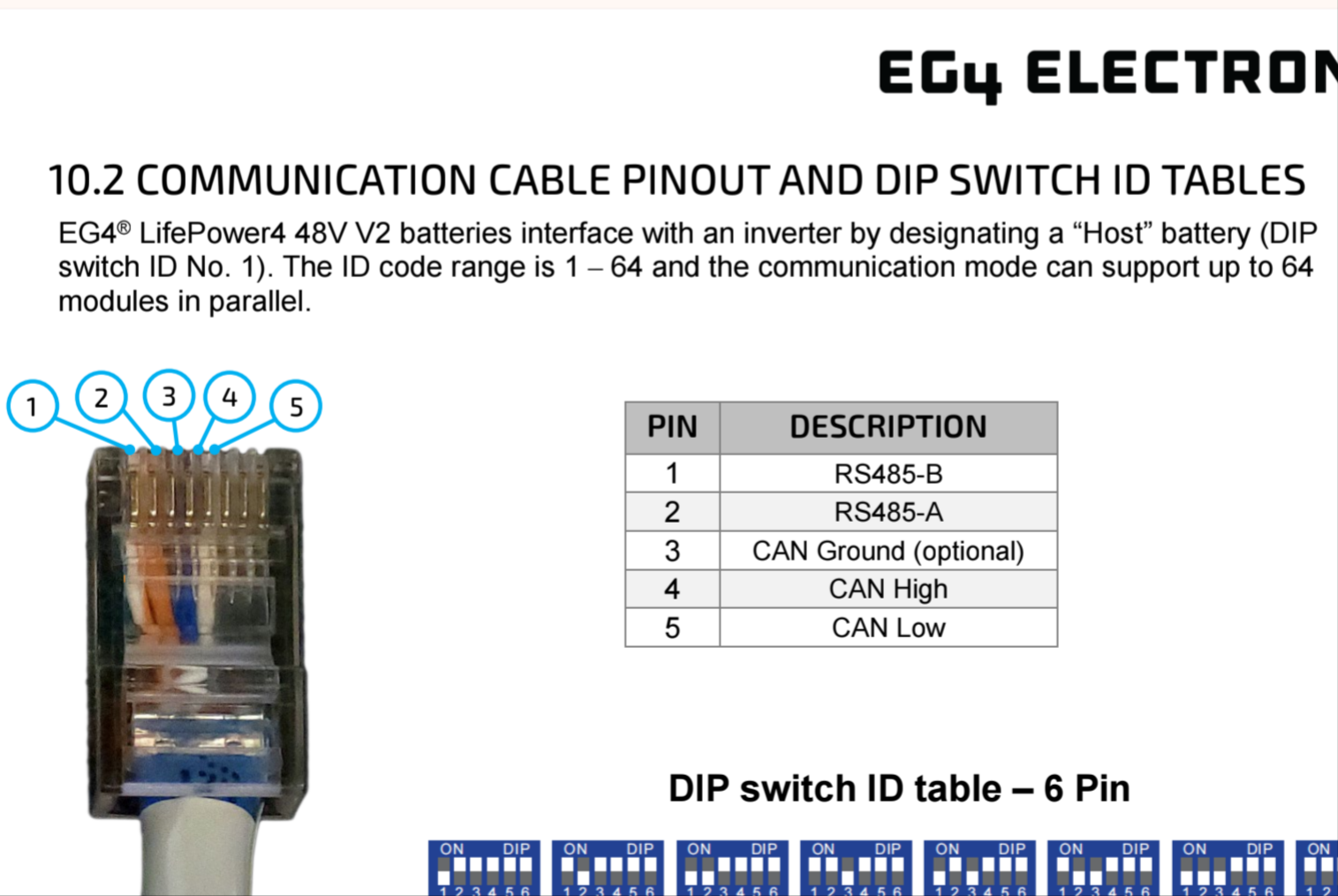

Is this the same with the LifePower4 V2 batteries with a six position DIP switch?  The manual for these batteries has this:
Screenshot 20250521 093949
 Which appears to say the master/host battery should be id ID:1

The manual for the LifePower4 V2 batteries has this:
 which led me to believe that the host/master should be ID:1.  Should I change my batteries to the scheme in your photo?

I see. I apologize for the confusion. I read BMS TEST so I assumed you were using the Lifepower4-V1.
You will need to set the Master battery to ID #64 which is all of the DIP switches up and the rest of the batteries can be left the same. I'm attaching a YouTube video to help with the process.

So with the V2, I use the BMS Tools, not the BMS Test, and my RJ45 should be plugged into Battery Comm.  I will give it a shot after changing battery IDs.  The video and the link are for the LL batteries, but I am assuming it is the same for the LifePower4 V2 batteries
