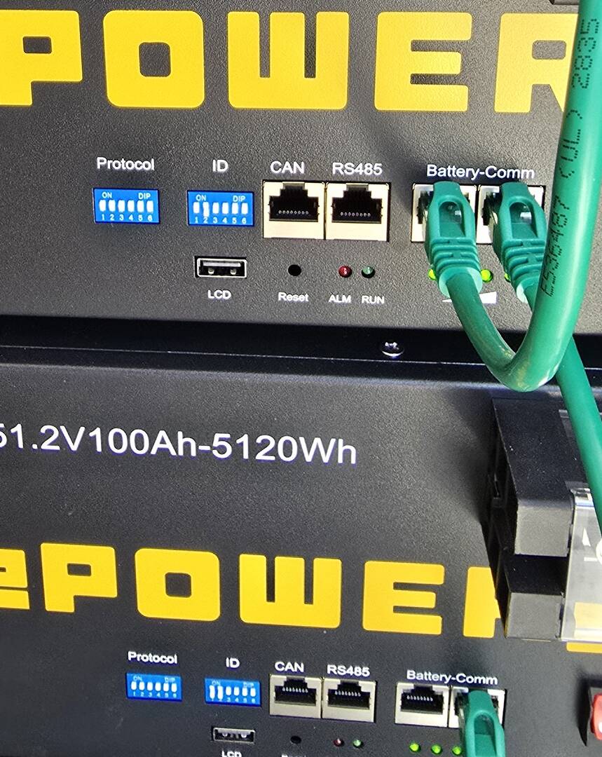

I could look at the battery with ID 64, but not the other 2.  The manual said to connect to the RS485 RJ45 jack, so that is what I did.  I assume it was ok, since the #64 battery talked.  Any ideas of why I can't talk to the other 2?  Here is a photo of batteries 2 & 3
