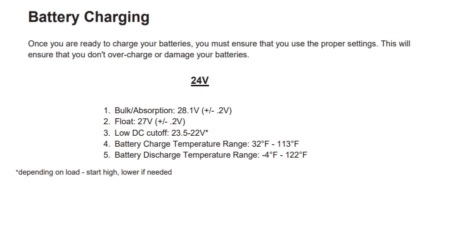

I found the Bulk/Absorption, Float, and Low DC Cut-Off in the image below.
However, regarding communication, if you're unable to set the system to one of the protocols supported by the EG4 batteries, it's best to leave the communication out of the configuration. Connecting the batteries together won’t have any effect unless they are actively communicating with the inverter.
