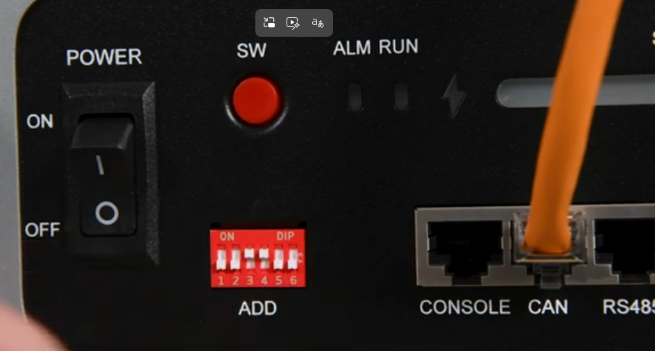

I hope I can get an answer as I've had 3 different answers depending on who I ask including Signature Solar and Current Connected. And my word the Pytes manual is horrible. It has a manual specifically for my battery and 6000XP - and under DIP says 'refer to your manual' lol - that's what I'm reading!!
My first question - prob first of many:
What do I set the DIP switches to on the Pytes V5° battery?

It looks like you would need to have 3 and 4 up and the rest down.
You can also check out this YouTube video that might help with this issue.
Pytes V5 Battery: Overview, Compatibility, and Real-World Testing
