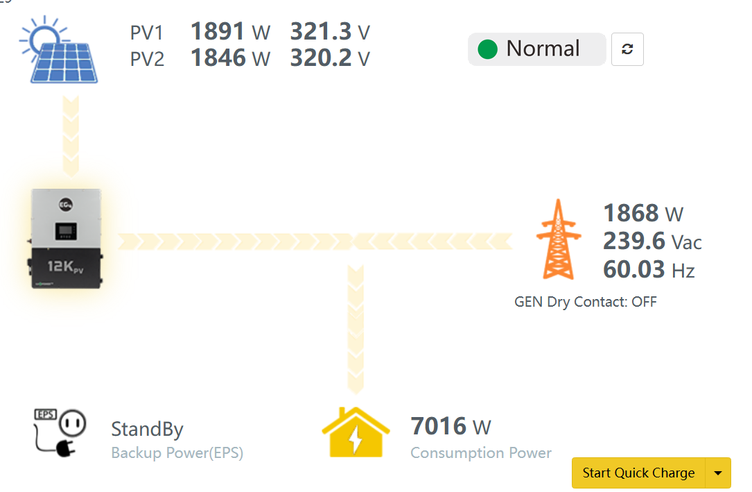

I have the exact same issue as this person
https://forum.eg4electronics.com/community/troubleshooting/loss-of-my-pv3-data-when-viewing-from-web-device-monitor-monitor-center/paged/3/

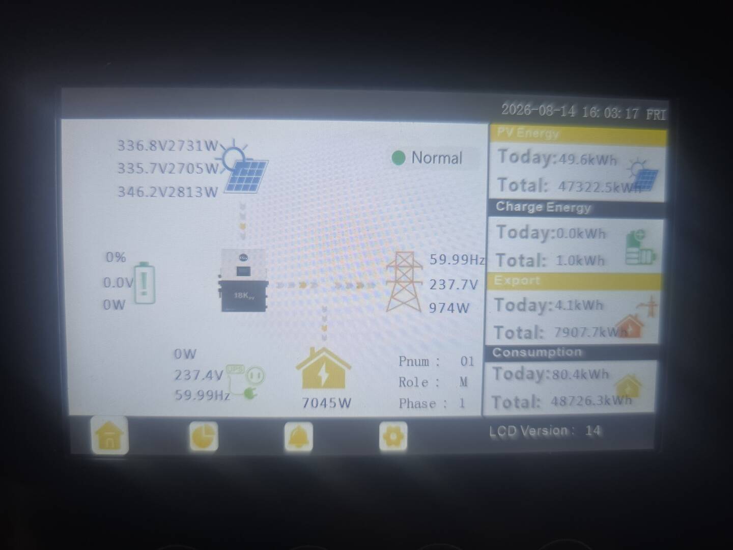

My 18kpv is being labeled as a 12k in the app and monitoring tools which is not showing a 3rd Array for pv3. It is producing and showing on the device, just not in monitoring.

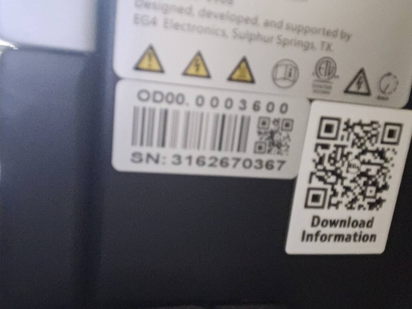

Device serial is 3162670367
you can even see the power is not adding up here

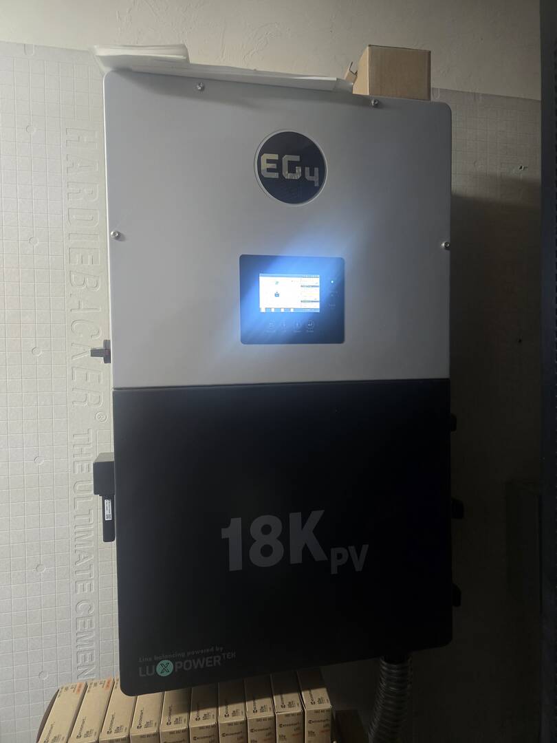

I can help you resolve this issue. Could you please provide a picture of the 18kPV so we can confirm the unit?

I apologize. I was out of town for a few days. I will just need the inverter's serial number. As long as the dongle is connected to the Wi-Fi, i can change the model remotely.
