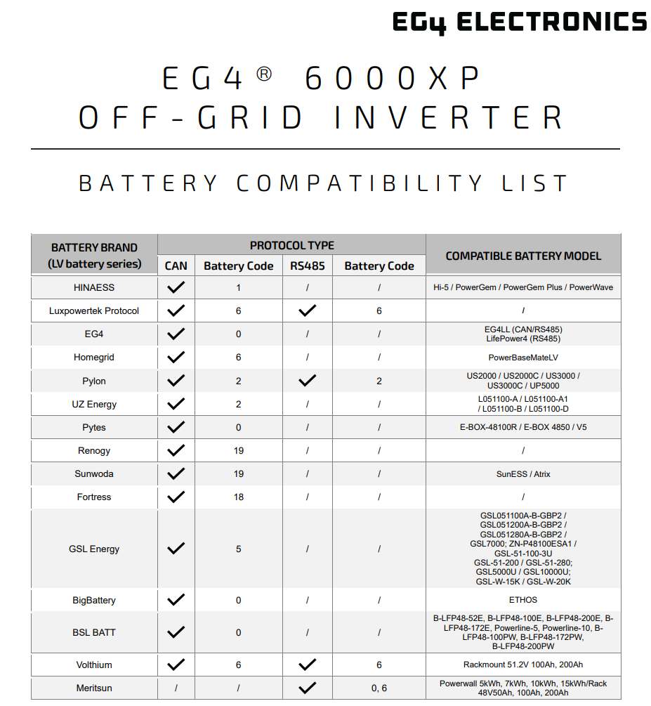

Do you know if the battery BMs has any protocols from the following list? If so, we can try to set the same protocol on the battery and the inverter for them to communicate with each other.
