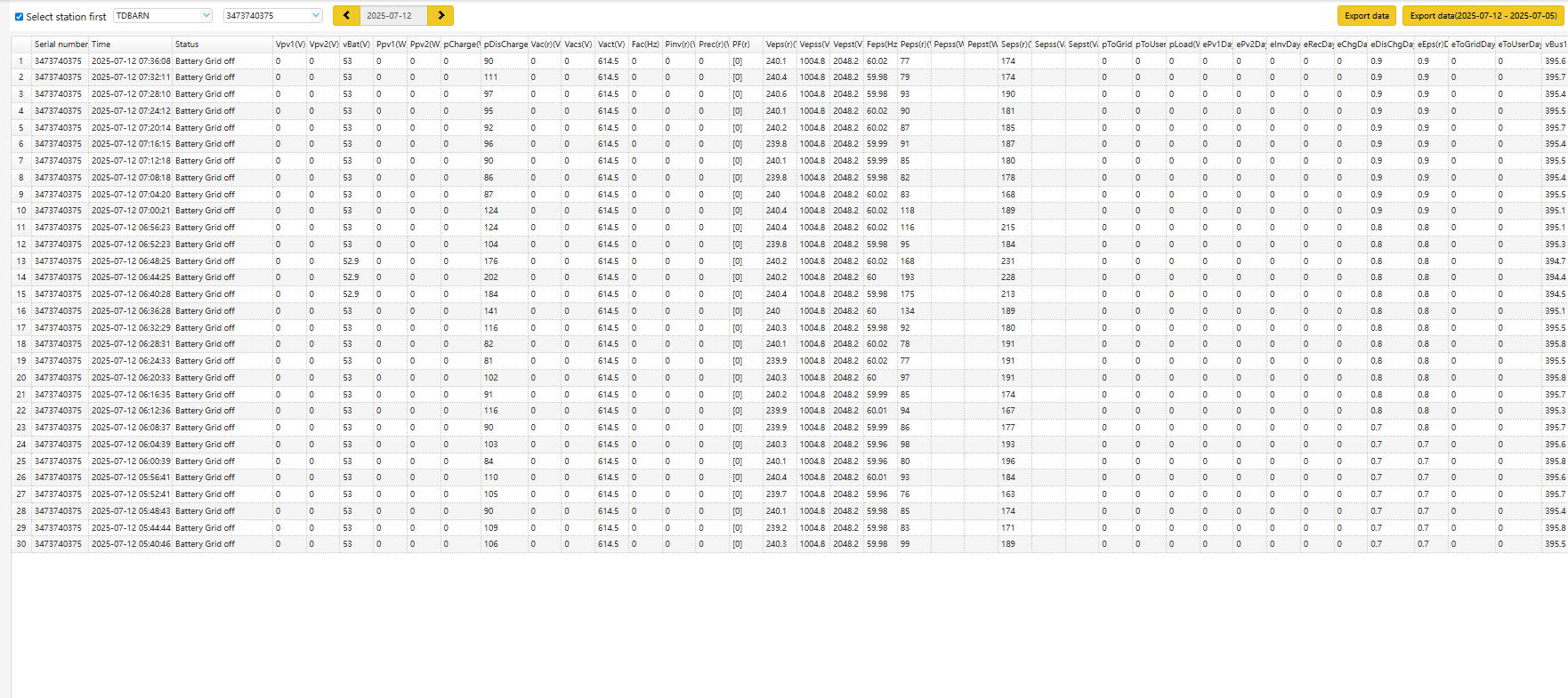

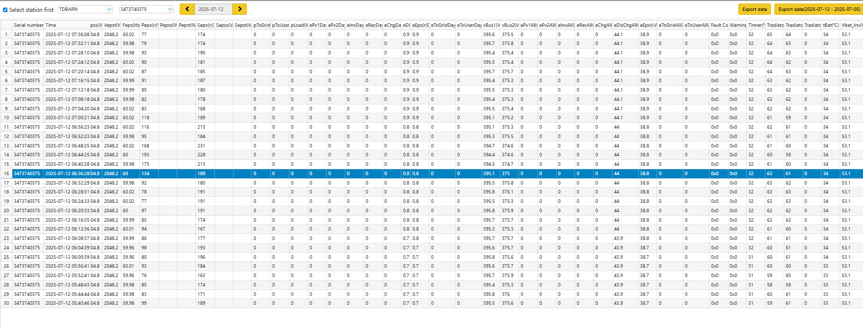

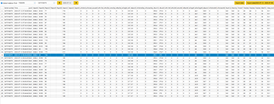

@eg4eric here are 2 screen shots of the same time period of probably the worst temperatures as you can see the tradiators are in the High 50 and mid 60 degree Celsius with the tinner at a cool 32 degrees C and the pdischarge watts are all less than 200.
I appreciate your skepticism of Solar Assistant data, but it only reports what the inverter is sending it -- no manipulation, it only does it in 10 second increments (instead of every 4 -5 mins) and reports all three of the temperature sensors unfortunately it only graphs the highest temperature.
