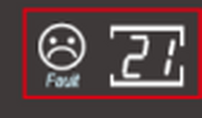

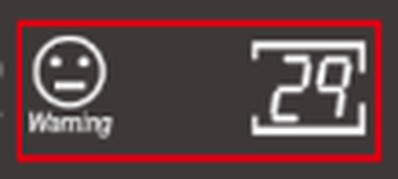

When you see the 25 do you see a frown face or a flat face?  Can you tell?
 or
If you can close up pic of the screen?

When it happens, it definitely says warning 25 with a flat face. it also restarts without my input.
I did a few shut downs and restarts: when it restarts, it shows an error 17 for a couple of seconds before showing the warning 25 again. Then it will restarts alone and either shut down immediately or stays on for a while.
