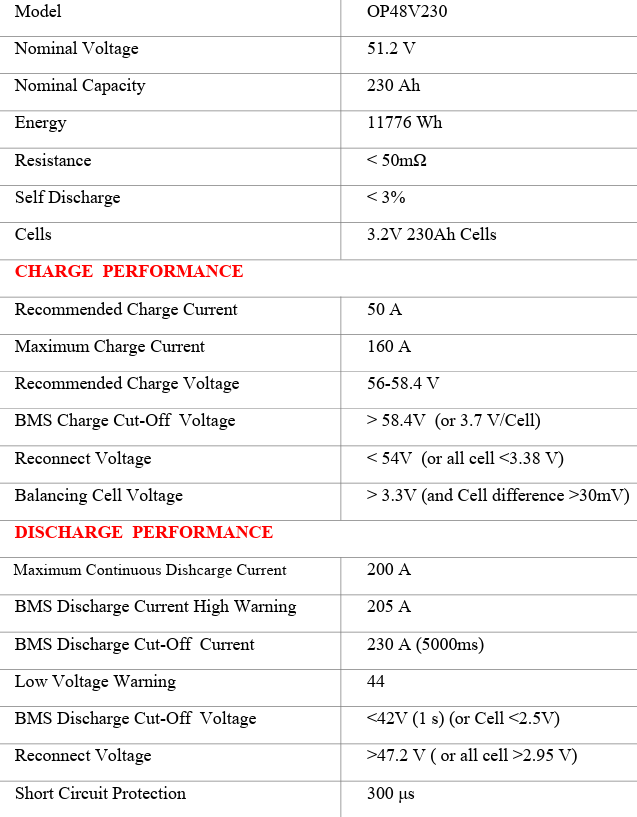

I have a single 6000xp. I need to make a new cable to communicate with my Orient Power Batteries. I have 2 5kWh 100 ah and 1 11.776kWh 230 ah battery.

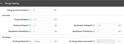

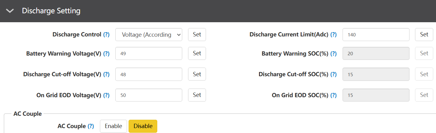

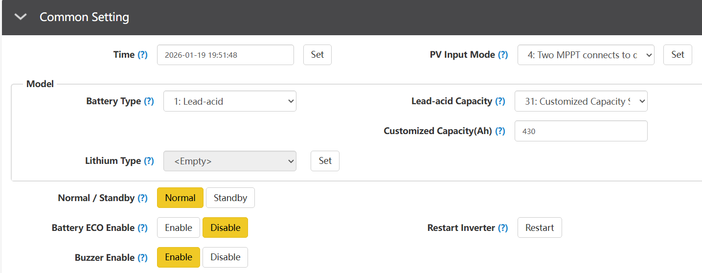

I set the inverter to lead acid with the following settings:
The following are the specs for the biggest battery in my array.
Would the settings be ok as lead acid for LiFePo4?

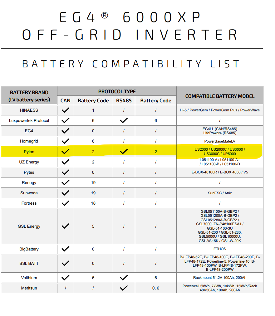

It is Pylon only.
Posts: 1285
@rick151
You can try setting the inverter to Battery Type: Lithium and Lithium Type: 2 (Pylon Protocol)

I understand, but I currently don't have a long enough LAN cable, so I would like to set to lead- acid in the meantime with no communication.
