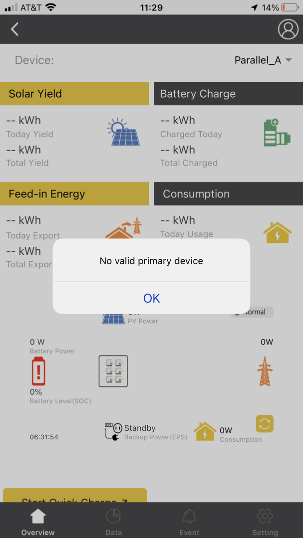

IMG 7290
Good morning Eric.
Thanks for updating the LCD’s. I still do not see separate string data on them unfortunately. Additionally, my EG4 Monitor iOS App is unable to connect or see anything - the App displays a dialog that says: No primary device. I haven’t checked the monitoring web portal yet as I’m working out in the field at the moment, but I’ll be heading back shortly.
