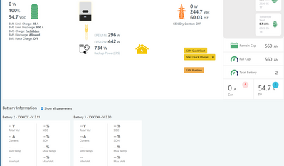

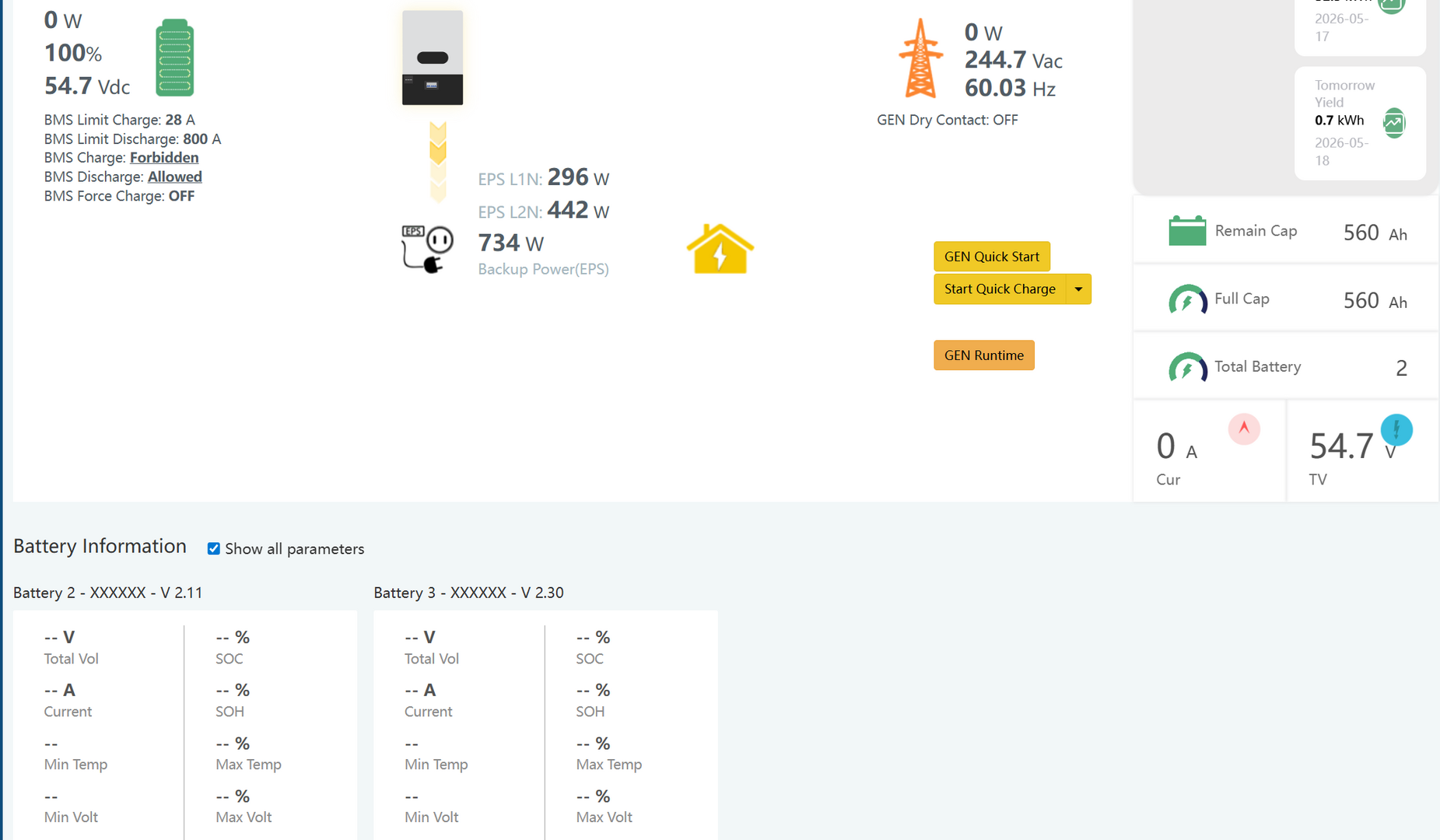

In the app it counts (4) batteries.  Under parameters it shows (2) and identifies them as batteries 0 and 1. It show correct detailed data for batteries 3 and 4 vice 0 and 1.
On the web page under monitor it counts (2) batteries on the right and BMS Discharge limit is correct for (4) batteries (800 amps) on the left.  The bottom of the page shows batteries 2 and 3 with no detailed data.
Under Configuration/Devices it counts (4) batteries and the correct battery capacity.

  1. If I only turn on batteries 0 and 1 the web site will display two batteries. Detailed data is not provided for the master but is for battery 1.
  2. If I turn on all four batteries, 0 and 1 are not displayed. Batteries 2 and 3 are displayed without detailed data.

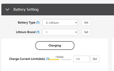

Ensure that you have the Inverter's Lithium brand to 1 instead of 0. If you share some pictures of how everything is connected that would be a great help! Just to ensure everything is correct.

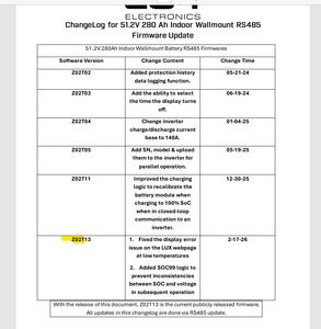

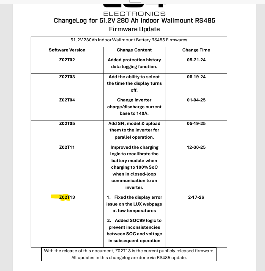

I believe the correct (latest) RS485 firmware is Z02T13 ... this corrected the problem(s) with the battery system settings on the monitor tab.

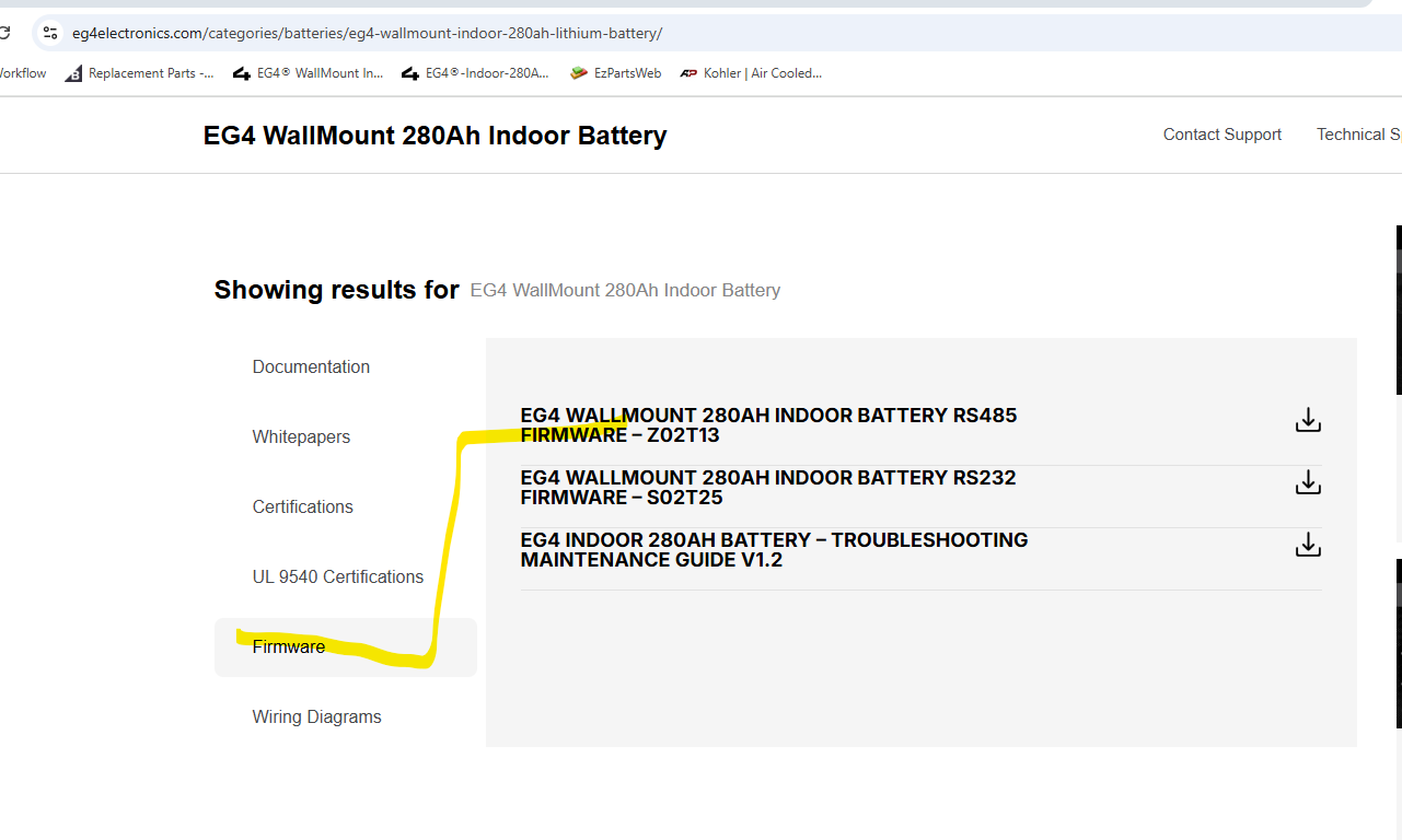

https://eg4electronics.com/categories/batteries/eg4-wallmount-indoor-280ah-lithium-battery/

Thank you for the link.  The site doesn't have a drop down for the 280ah indoor under batteries, so I used searched.  The search firmware version listed is 11.  I will update to 13 tonight and report back.  I do have the inverter set to: Lithium brand to 1 instead of 0.

Update to RS485 firmware is Z02T13 fixed the issue.  Thank you very much for your help.
