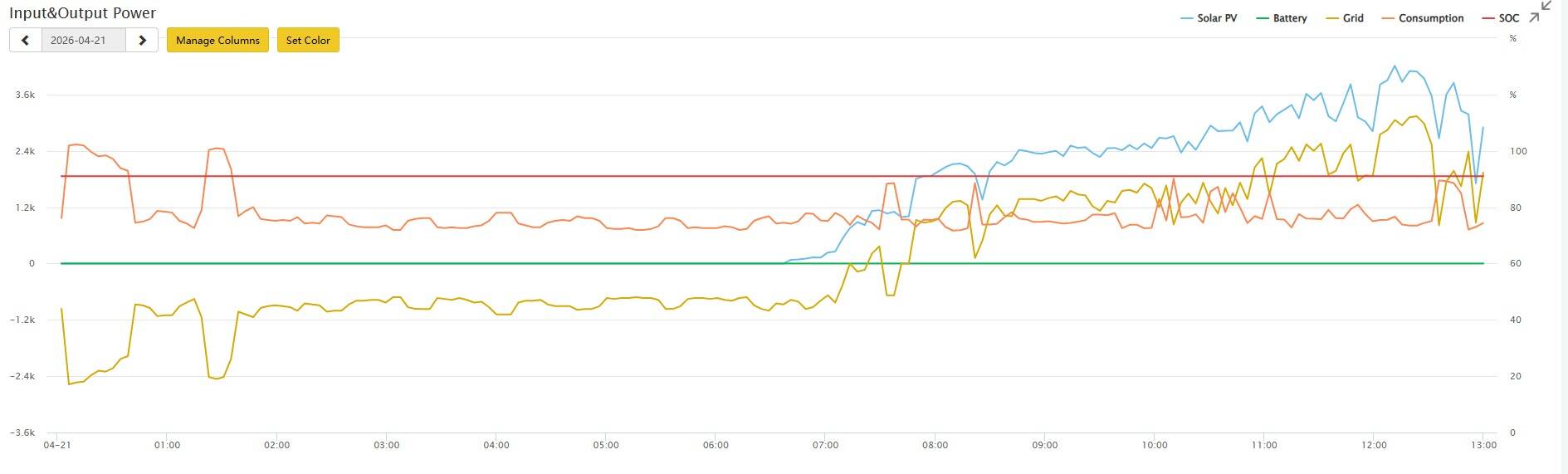

Solar graph peak shaving ignored 4 21 26
This system has been running for several months now and I thought it was running pretty well. Lately, it has started ignoring "Peak Shaving" settings. If you look at the settings, it should be in Peak Shaving mode from 5:30 to 8:30, am and pm. When you look at the graph, it totally ignored those settings this morning, for no reason that I can see. The load is quite low, and the batteries are charged over 90%. Yet the system just pulled from the grid as if the batteries were irrelevant. This is a pattern that started occurring recently despite having been running properly for the past few weeks. ?????????

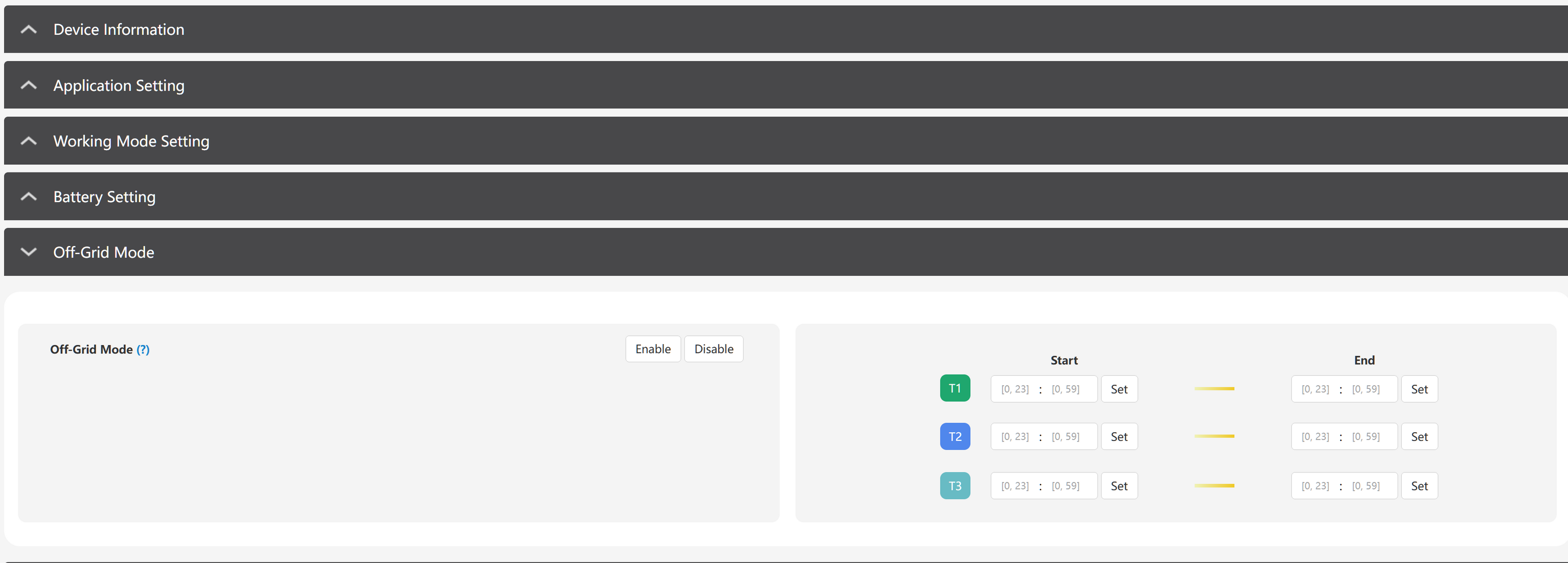

Another work around I just found is in working mode you can now schedule off-grid mode , I have asked for that since my peak shaving and grid seem to be erratic. I get some grid power and send some grid power now and then while peak shaving, not in off-grid mode though .

@jckemp3 I haven't restarted the inverter yet, but I will. The system is continuing to behave as if there are no batteries. The inverter is an 18kPV. Do you know if this inverter has a habit/history of periodically losing its mind? This is the 2nd time in 3-4 months that this has happened.
I am not seeing where to schedule off grid mode.

I have the 12kPV version . I have had a fairly smooth experience with my inverter, most issues I have created in my learning .
{5951E77C 5C47 4EC3 91A1 51F830937A63}
This is from the Maintenance Tab- Working Mode , Below the Battery settings I have the Off-Grid mode section.
Hope this helps

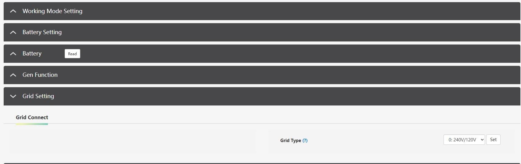

grid menu
Curious. I don't have that menu. I wonder if there has been a system upgrade that I don't have.

I am on the newest 2727 firmware and lcd screen firmware. I believe you were on 2525 and a much older screen firmware.  Dont know if that is the difference.
