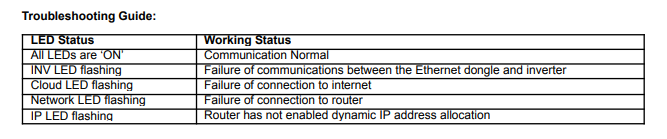

Whenever you see it offline and you are at the location, take a picture and see what lights are on or flashing. That will tell us if its disconnecting from the internet or from the cloud.
4 Replies
(@rbeato011)
Posts: 5
@eg4eric the cloud light flashes (2nd light). They said they were going to send me a new dongle.
@rbeato011
Perfect. Here’s a guide to what each blinking light indicates. If the Cloud light is flashing, it means the device is having trouble connecting to the internet. It could be an issue with the cable or the dongle.
(@rbeato011)
Posts: 5
@eg4eric it was concluded dongle needs replacement, just waiting to be sent the new dongle. Thanks
@rbeato011
Great, if you need anything or have any other questions, feel free to reach out.
