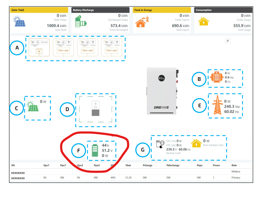

@eric any update on this. I am seeing a similar issue after bringing the nging my Gridboss and Flexboss21 online last night. The Gridboss does not show any battery data.
Posts: 1285
@mboo42 Are you saying that it's not showing the battery as shown in this picture?
(@mboo42)
Posts: 7
@eric that is correct

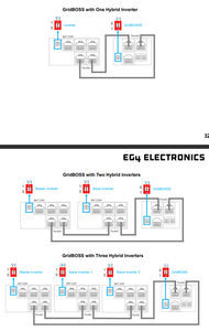

Posts: 1285
@mboo42 Do you have the parallel cables set up correctly as shown on this design?

Posts: 7
@eric I was on with Tech Support this morning and we corrected the parallel cables so they should be set up correctly now. However, I still don't have communication. On hold right now to see how the escalation went.

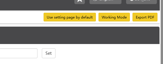

Posts: 1285
Is the "Grid Boss Enable" option Enabled?
This would be located in the settings on the top right under "Working Mode" and then under "Advanced settings"
