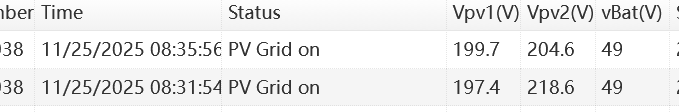

This is what data history looks like when I look at Data History using the Web monitor -
Notice that Vpv3(V) is missing.

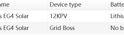

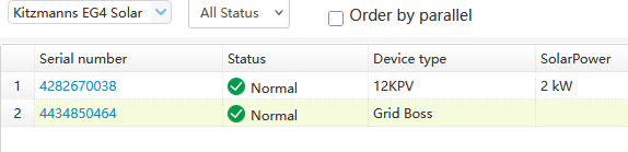

Then also, if I look at Configuration Devices in the Web monitor, it shows 12KPV. Which is wrong.
Again, it appears that the problem is on your side, misidentifying the inverter type and displaying the wrong (missing) information

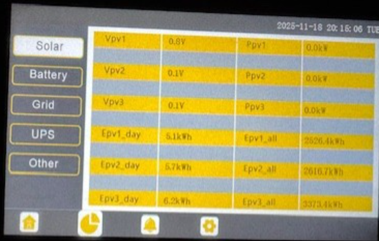

I don't know what picture of the inverter you want? Physical connections of solar or pictures of the display?

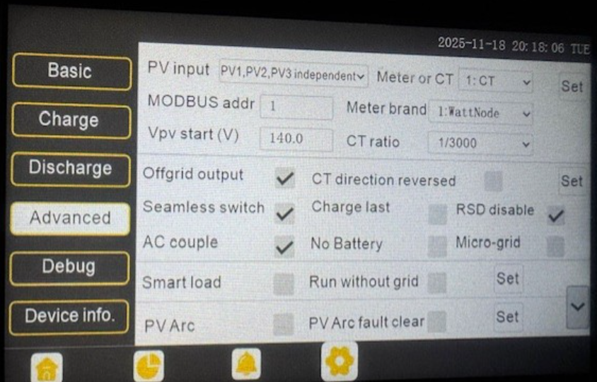

PV Input settings -

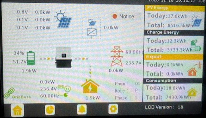

Home display. Note that this is during night so no active solar at this time -
Current measured solar. Again at night so no power is being generated -
All show 3 PV inputs but the monitoring app shows only 2 -
and the monitoring app also shows the inverter to be a 12KPV

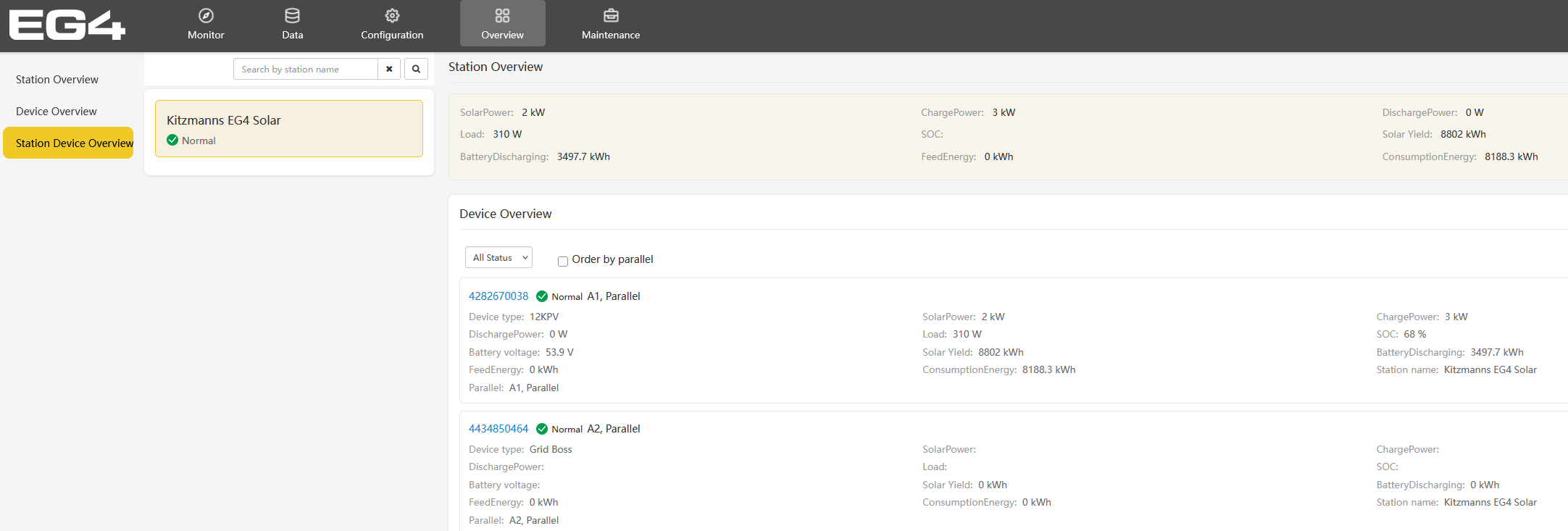

Also, station overview is also reporting as 12KPV. Again this is wrong since i have an 18KPV -
Something on your end got changed from a 18KPV to a 12KPV. This used to work but somehow got changed to12KPV around 6 weeks ago.
Let me know if you need anymore pictures or data.
