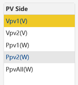

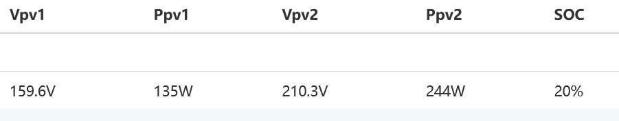

So I updated my LCD screen to 23/1/1.
Still no change and still missing my solar 3 in the Web app.

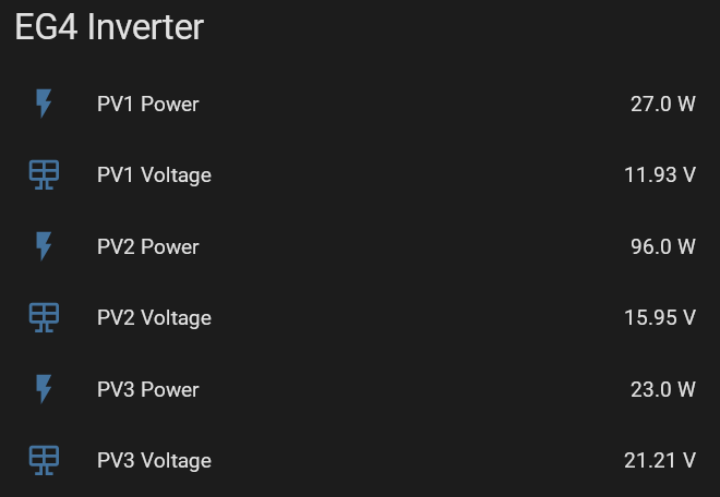

I would assume that you can view the raw data stream from the inverter that contains all 3 PV streams. Also remember that all 3 PV's show up in my Home Assistant -

I was looking into this, and I saw that the 12kPV only has 2 MPPT's.
