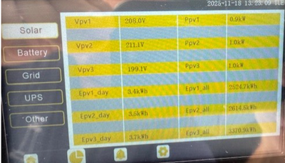

I also discovered that the screen on my 18KPV shows that it does see all 3 PV inputs -

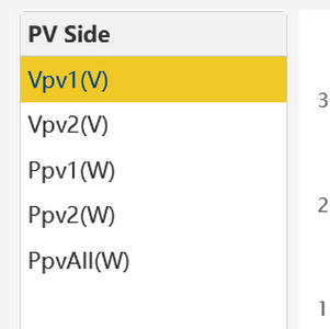

While the web app shows the first two PV inputs like this -

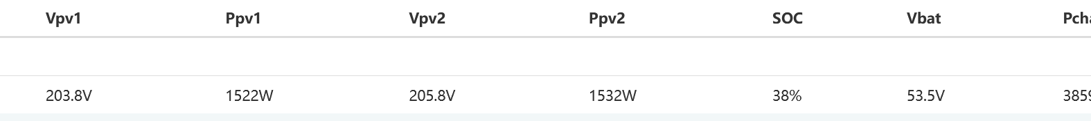

and this -
Again, the Web app used to display all 3 PV input data but now is missing it for PV#3.

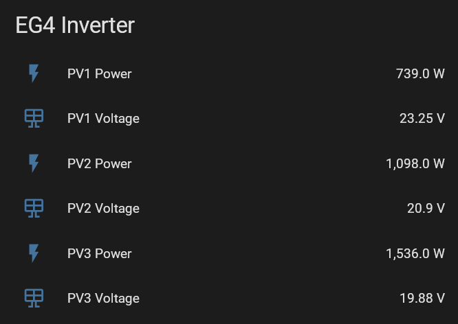

BTW My home assistant reports all 3 PV inputs -

Yes - I had verified both the voltage and current for all 3 MPPT inputs and all are accepting power on there inputs. So the inverter is actually using the power and actively displaying it on it's LCD screen, but the solar for that input is not showing up any more on the web app when it had previously. The other 2 MPPT's are reporting properly on the web app. Also note that MPPT3 is reporting in my Home Assistant properly, so the problem is pointing to either the web app or it's lack of population through your web server.
