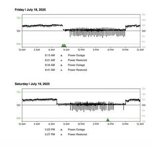

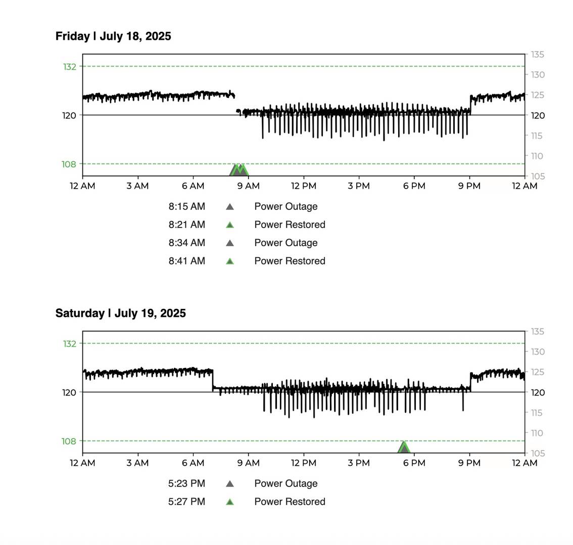

I have been having the same problem. My FlexBoss21, GridBoss  and wall battery went online in November. No hardware changes but I took the advice on the EG4 YouTube video and got EG4 support to walk me through an updated Firmware install. After a few calls because my system went almost all the way down, they had me Reboot the system. That was on Friday 7/18 and it got the system running like it was after I was walked through a Reboot Solar exercise.
Then on Saturday my blackouts started. One on Saturday, two on Sunday, one Monday and Tuesday, all at different times. I've worked with two technicians at EG4 with lots of Enable/Disable changes made to no avail. I'm going to do a Reboot one time today and if that doesn't work we've discussed returning my system to the old firmware.
I've attached a jpg of my weekly Ting (Friday and Saturday only) report that shows the Friday Reboot and the Saturday outages.
Ting Blackout 7 23 25 at 8.57 AM
