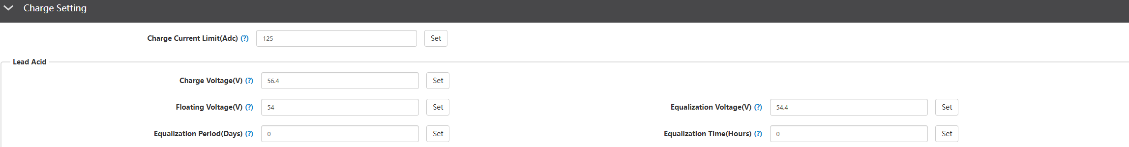

I am  only familiar with 6000xp with EG4 wall mount battery.
Below are my settings for Lead Acid (as per SS tech support)
BTW
For some reason I could not male it  work as per voltages when in Lithium battery mode - only SoC worked and vice versa - SoC setting did not work when in Lead Acid mode.
Maybe I'll try again in the future, but now I ma comfortable with Lead Acid battery and Voltage settings. (basically is like set it and forget it)

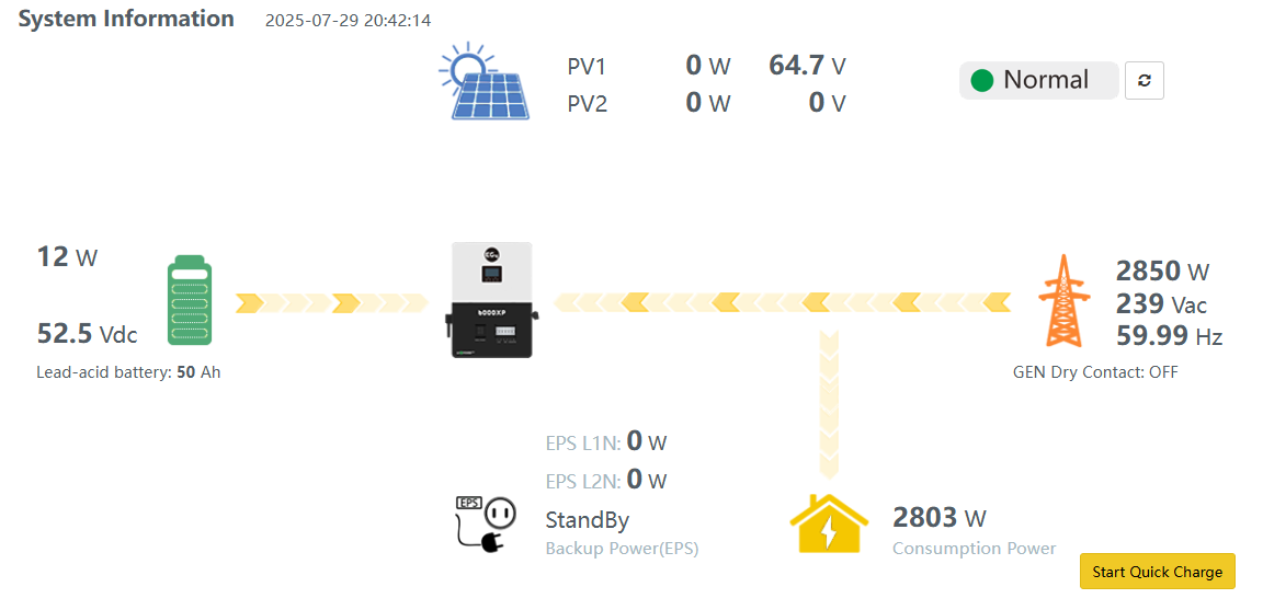

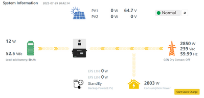

I have had the Lead Acid as my battery type since yesterday morning and no blackouts so far. (knock on wood)
i may be missing something but I see your point above about the visibility of the SOC on the phone app but it is shown on my laptops version of the Device Monitor.
Her is the link to the program as well as a photo of the screen.
https://monitor.eg4electronics.com/WManage/web/monitor/inverter
Image 7 29 25 at 4.15 PM
For some reason I can't drop the full size screen print. It's a small file. Just open the program on your computer.
I hope it works.
