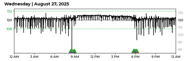

I had a similar experience running on Self-Consumption Mode except AC Charge Mode during the day to charge the batteries using AC Coupled Solar input through the Flexboss21 load ports ( https://eg4electronics.com/wp-content/uploads/2025/04/EG4-How-to-AC-Couple-on-Load-Port-w-EG4-Hybrid-Inverter-and-GridBOSS.pdf )... I experienced power outages just before and after changing from Self-Consumption to AC Charge Modes... Lots of brown outs (Vac < 108V) throughout the time in Self-Consumption Mode… Here's an example Ting graph:
System is a GridBoss, 2 FlexBoss21, and 6 Wall Mount Indoor batteries all connected in parallel with one inverter as the master… PV is 39 SunPower SPR-X21-335-BLK-C-AC Solar Modules (13,065 W DC) with Enphase microinverters connected as 3 strings of 12 and 1 string of 3… The PV is connected to the FlexBoss21 Load Ports per https://eg4electronics.com/wp-content/uploads/2025/04/EG4-How-to-AC-Couple-on-Load-Port-w-EG4-Hybrid-Inverter-and-GridBOSS.pdf simply because of the separation between the GridBoss and FlexBoss21's and the lack of additional conduit space between them… 2 strings of 12 into 1 inverter load port and the remainder to the other inverter load port...
