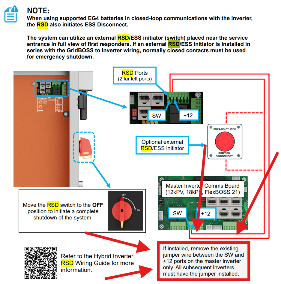

I needed to test the RSD/ESS buttons. I received unexpected results and need to know if I am incorrect.
The RSD is connected between the main FB 21 and the GB. I disconnected the external switch, but when it was connected, saw the same results. The house is connected to the back up ports in the GB

Did you remove the existing jumper wire between the SW and +12 ports?
