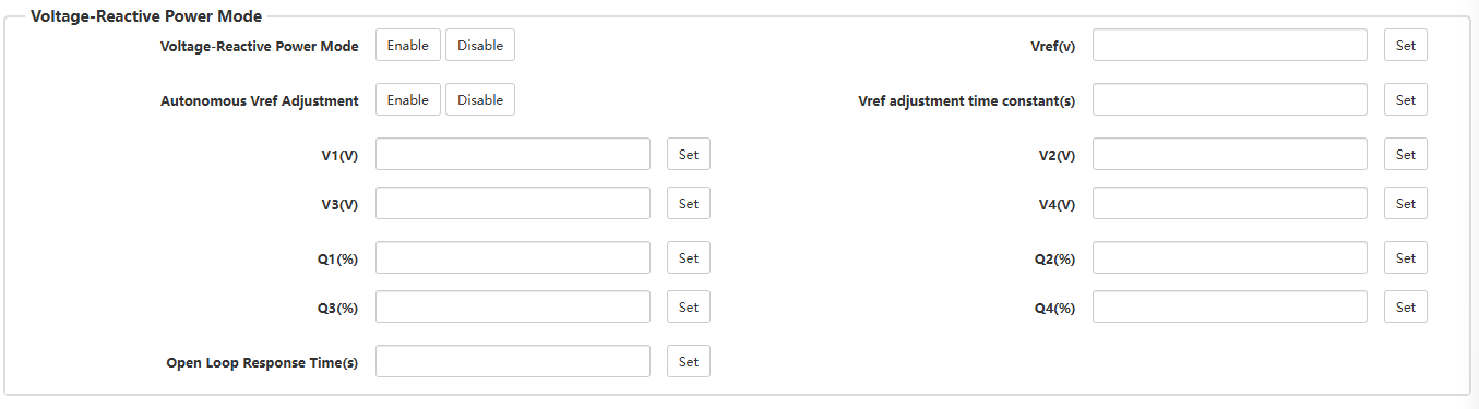

Thanks for the reply.  the Utility requires me to send them a screenshot (from the monitor.eg4..) or picture (from the LCD).  there is no setting for 'Volt Var' in the monitor or the LCD display that i can find.. so i would assume it's hard set in the firmware.  do you know what setting I'm talking about or where it can be located?
Posts: 1078
@captjwh
I believe this is the setting picture you need. This setting is not available for the end user.

@eg4eric thanks.. I'm the home-owner/installer.  how do i get access to those values on my system????  that is probably exactly what they are looking for!
Posts: 1078
@captjwh
End users don't have access to these settings. However, if there is anything else I can provide for you, please let me know.
