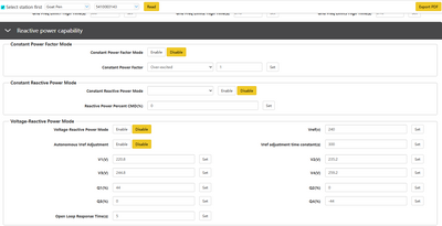

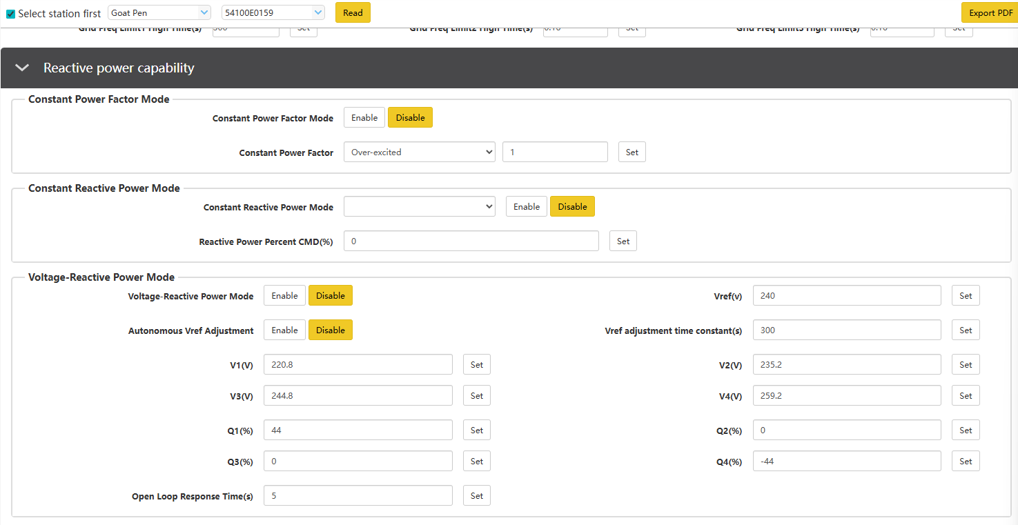

I'm the one who installed the system and who is 100% responsible for it.  Can you at least take a pic of it and post it here for my system?  Please?   i got 30k of a rebate waiting on this pic.  thanks!
@captjwh
If you have an installer account, you possibly have access to it, you can go into maintenance tab and go to UL Compliance on the left side, or you can share the inverter's serial number, and I can take a screenshot.
(@captjwh)
Joined: 11 months ago
Posts: 19
@eg4eric I don't have an installer account. 🙁
It would be absolutely great if you could snapshot that data!
Grid Boss 5263850587
FlexBOSS21 54100E0159 - Master
FlexBOSS21 54100E0143 - Slave
Thank you Eric!
@captjwh
This is the Master inverter- 54100E0159
This is the Slave inverter- 54100E0143
The Gridboss does not have any data in it, as it is not an inverter.
