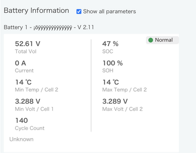

I updated all 4 of my indoor 280ah batteries to this firmware version and it completely destroyed the BMS reporting data to the cloud server. EG4 support does not have answers on this after spending an hour and a half with them on a call.

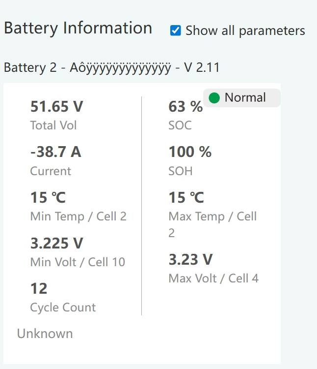

(@energybalanced)

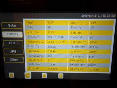

@solargear I also experienced the same issue when completing an upgrade yesterday evening on 3x Indoor Wall Mount 280Ah, and I was planning to contact support. Thank you for checking in with them - I will probably still do so just to log the issue.
I did confirm that my inverter still treats the battery system as having the same capacity and charge/discharge performance as the 3x batteries. I'm continuing to operate while keeping an eye out for any odd behavior and waiting for a fix.
Screenshot 20 1 2026 192427 monitor.eg4electronics.com
PXL 20260120 024228422

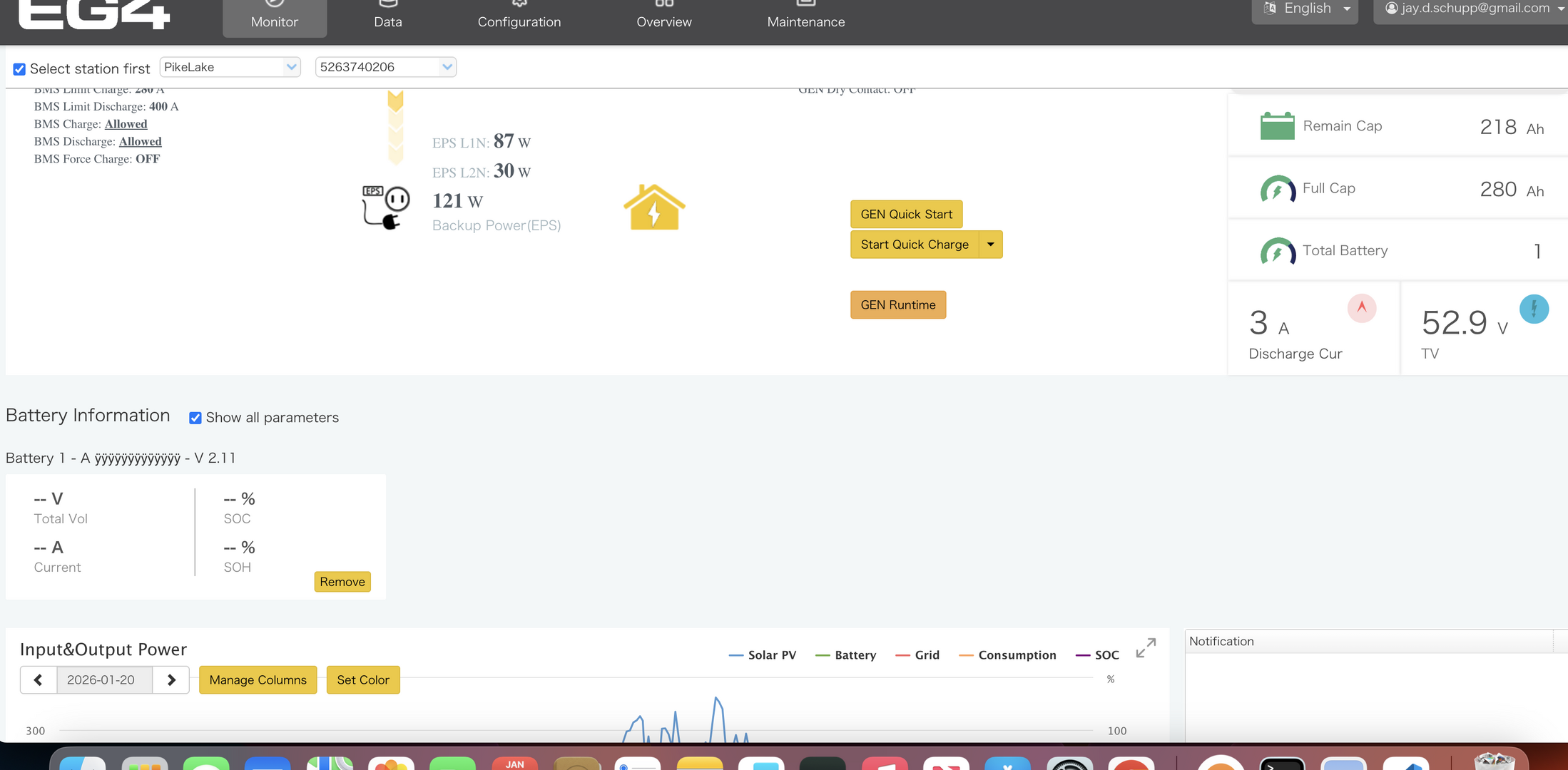

(@yooperjay)
Posts: 19

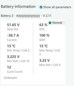

Well, I am not the only one!  I have 2 batteries but only 1 showing up with the same weird characters for the battery.  The configuration shows 2 batteries but the monitor / BMS reporting is trashed.
Glad you posted this as this is installed off-grid at our cabin 2 hours away and I was going to drive up tomorrow to try to figure this out.
I noticed your version is 2.28 but the firmware update was 2.11 I thought?
Hopefully they can figure this out quickly!!!

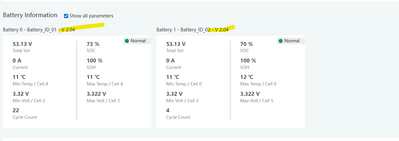

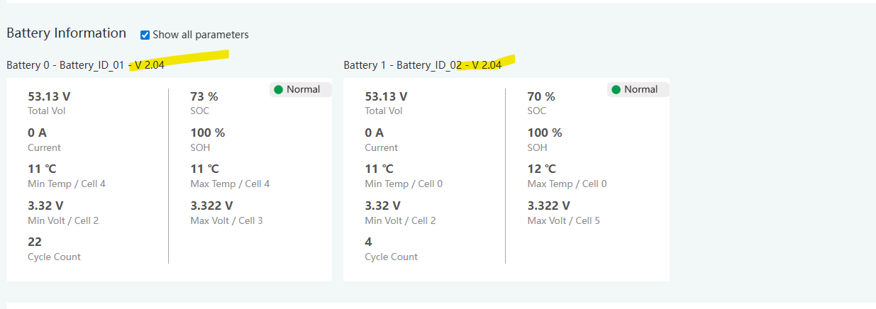

Ok, stuff like this drives me crazy.  Drove the 2 hours to the cabin...loaded the oldest versions of the firmware both RS232/RS485 that I could find for the Indoor Wallmount 280AH batteries.
RS485 -> Z02T04 (which is what I think they were before the update to Z02T11)
https://forum.eg4electronics.com/wp-content/uploads/wpforo/attachments/257/2258-EG4-Wallmount-Indoor-RS485-Firmware-Z02T04.zip
RS232 -> S02T11 (not sure which version they were before the update to S02T25)
https://forum.eg4electronics.com/wp-content/uploads/wpforo/attachments/6/19-EG4-Indoor-280Ah-Battery-Firmware.zip
Both batteries are showing again in the monitor.  So a workaround until they fix the updates which toasted things perhaps?
Hope this helps!!
Thanks.

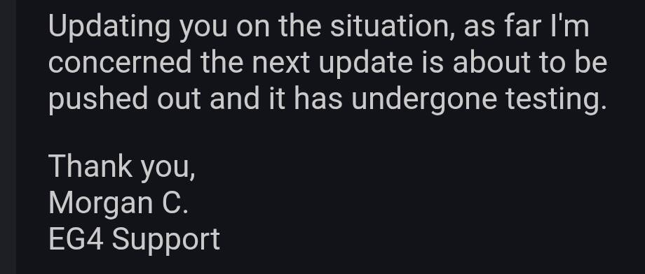

(@solargear)
Posts: 4
Posted by: @eg4eric
@solargear @energybalanced @yooperjay
Ensuring that both the RS232 and RS485 firmware are updated to the latest versions should resolve this issue.
This does not solve the issue. Both firmwares were updated to the latest and did not fix anything. I also tried to update the rs485 firmware with the allweather battery which resulted in the same issue. There is a serious disconnect at EG4, support is telling me that a new battery firmware will be released soon? Please explain?
Screenshot 20260123 145801 Gmail

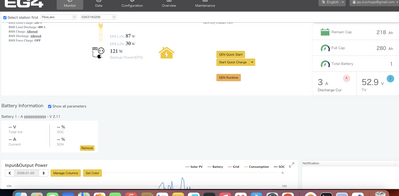

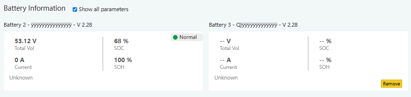

(@powerup)
Posts: 74
We just joined your Party. Our remote clients batteries are now BRICKED. S02T25 & Z02T11 on 280AH wall-mount.
The 12kPv system teases us by showing only one battery and switching every so often to only show the other.
With the strange names for the batteries. Seems that the path to recovery is to send a truck and schedule with the client to roll back the firmware.
It is sad that Eric @eg4eric takes all the heat for these issues and doesn't have the support of engineering.
Screen Shot 2026 01 26 at 8.26.20 AM

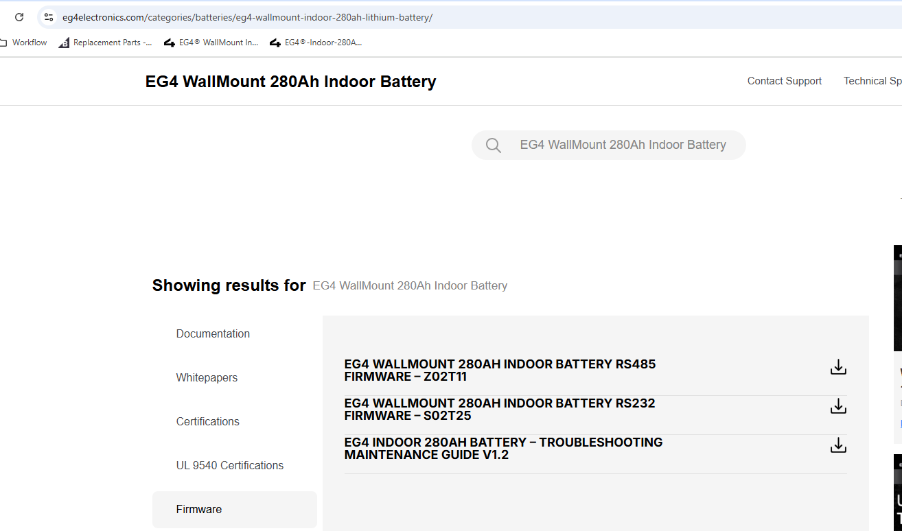

Posts: 1285
@solargear
We will ensure this gets corrected. The latest firmware for all batteries is available on each product page. We were advised that installing both firmware updates should resolve it; however, if some customers are still experiencing the problem, we will continue to look into it and work toward a permanent solution.

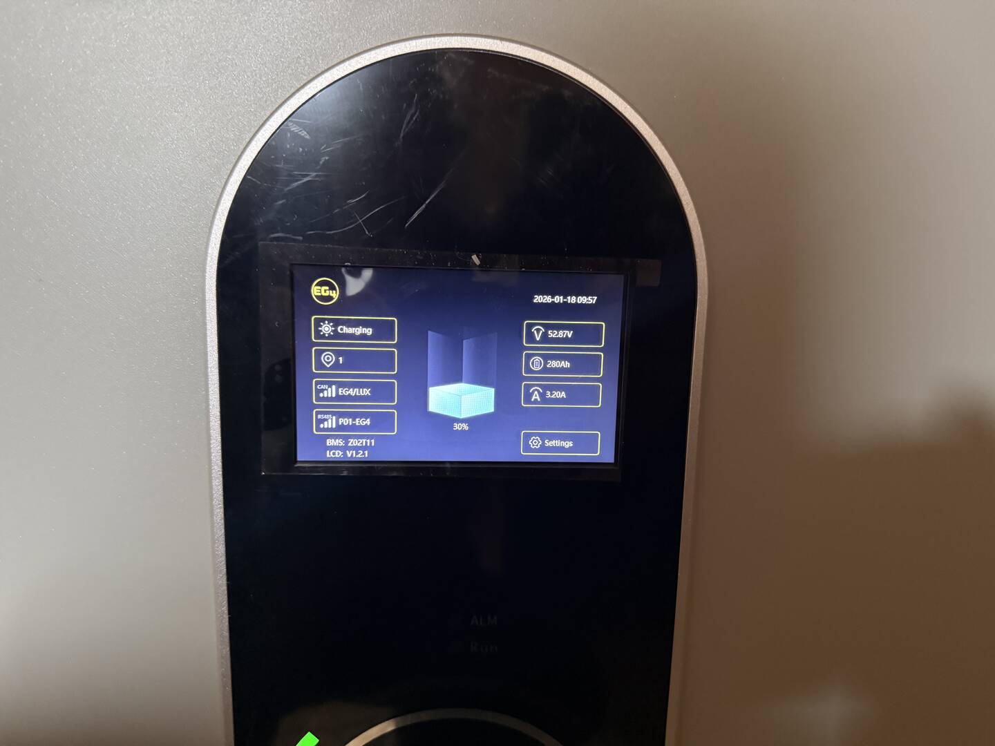

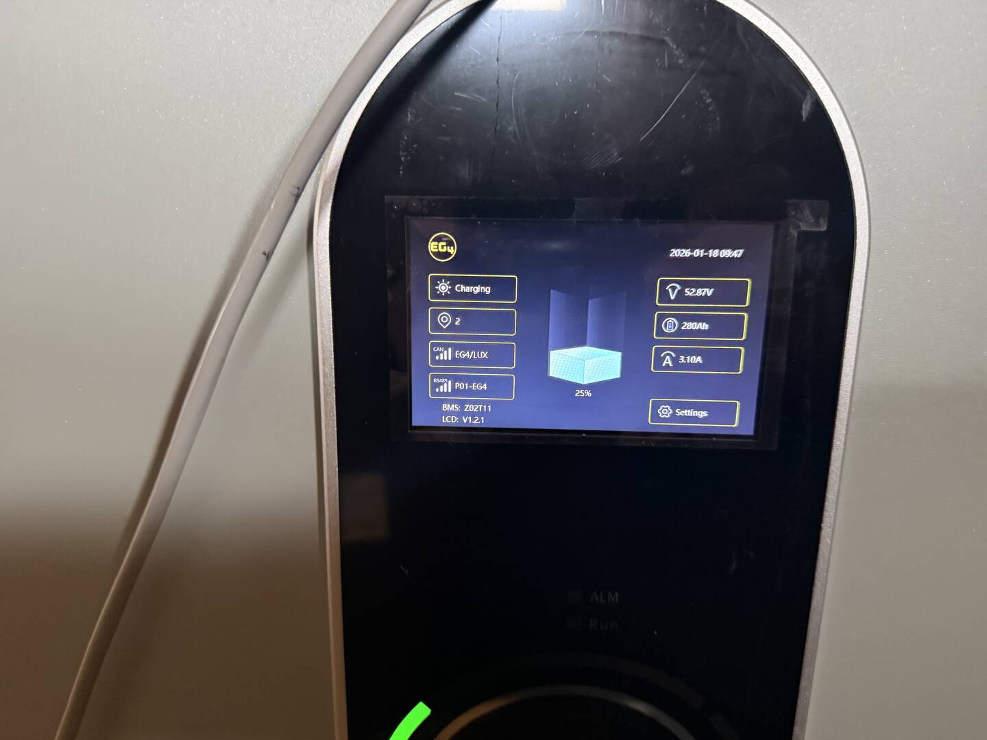

(@yooperjay)
Posts: 19
@eg4eric
Are the LCD screens working?  Yes, screenshots attached for both my batteries showing Z02T11
Does the monitoring show the correct battery capacity?  No, not really only showing 1 battery in my case at 280Ah (see post above from  January 20, 2026 8:23 pm).  It seems an issue with the monitor / battery information.  It does seem the "system" still thought it had 2 batteries / capacity (just looking at usage and the data logs) but the monitor page was not recognizing the correct number of batteries and showing weird characters in the information (which can be seen in the screenshots in this thread).
IMG 1587
IMG 1586
