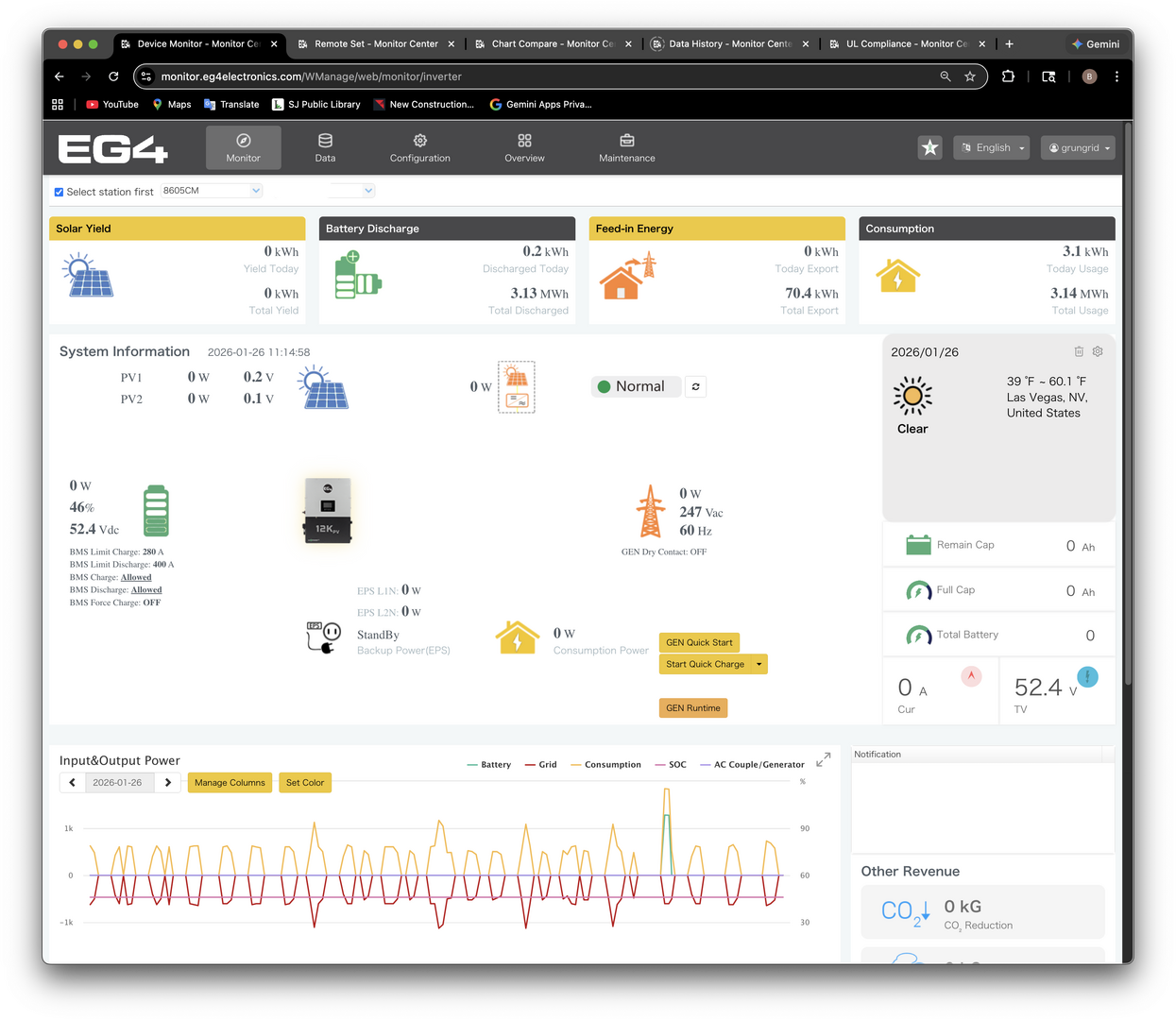

Clients battery screens had the correct details AND displayed newest T11. Used the firmware adapter and both batteries issued Success signals.
When the batteries (individually) were on the monitor page display it showed a single battery and 280AH Capacity.
NOW - I have 0 batteries showing at all (I placed System  in "Standby Mode").
Screen Shot 2026 01 26 at 11.16.03 AM copy
Posted : January 26, 2026 8:58 pm
(@powerup)
Posts: 74
@yooperjay You're lucky that you still see 1 battery. Both have disappeared for our client.

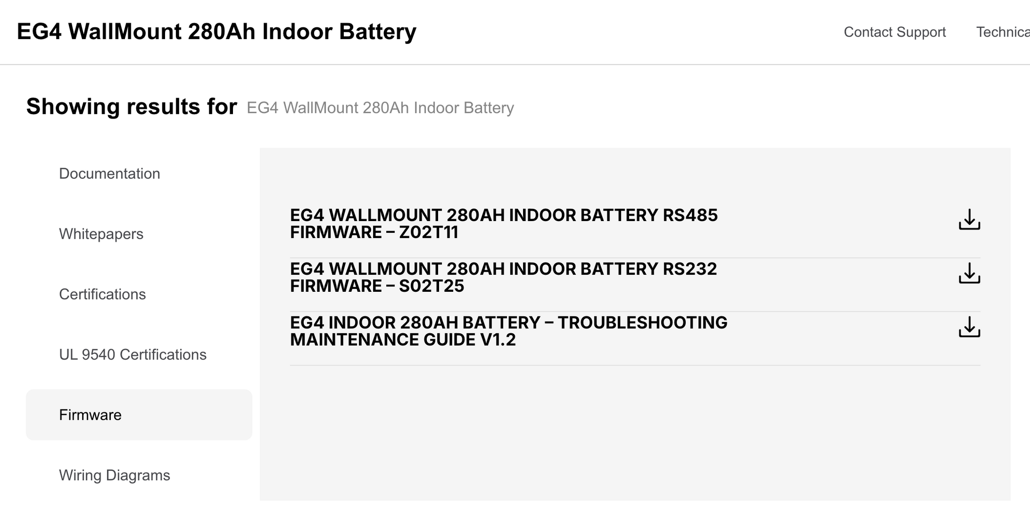

Where can I find the previous version of firmware for the 280ah all weather wall mount?
Posted : February 6, 2026 6:21 pm

Posts: 1294
@james
You can find it here ↓
Indoor Wallmount – EG4 Community Forum
Posted : February 12, 2026 9:30 pm
