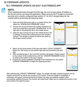

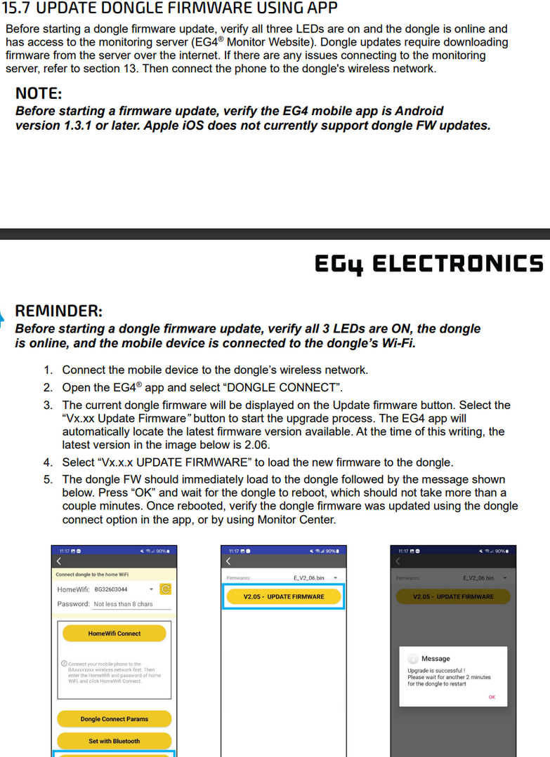

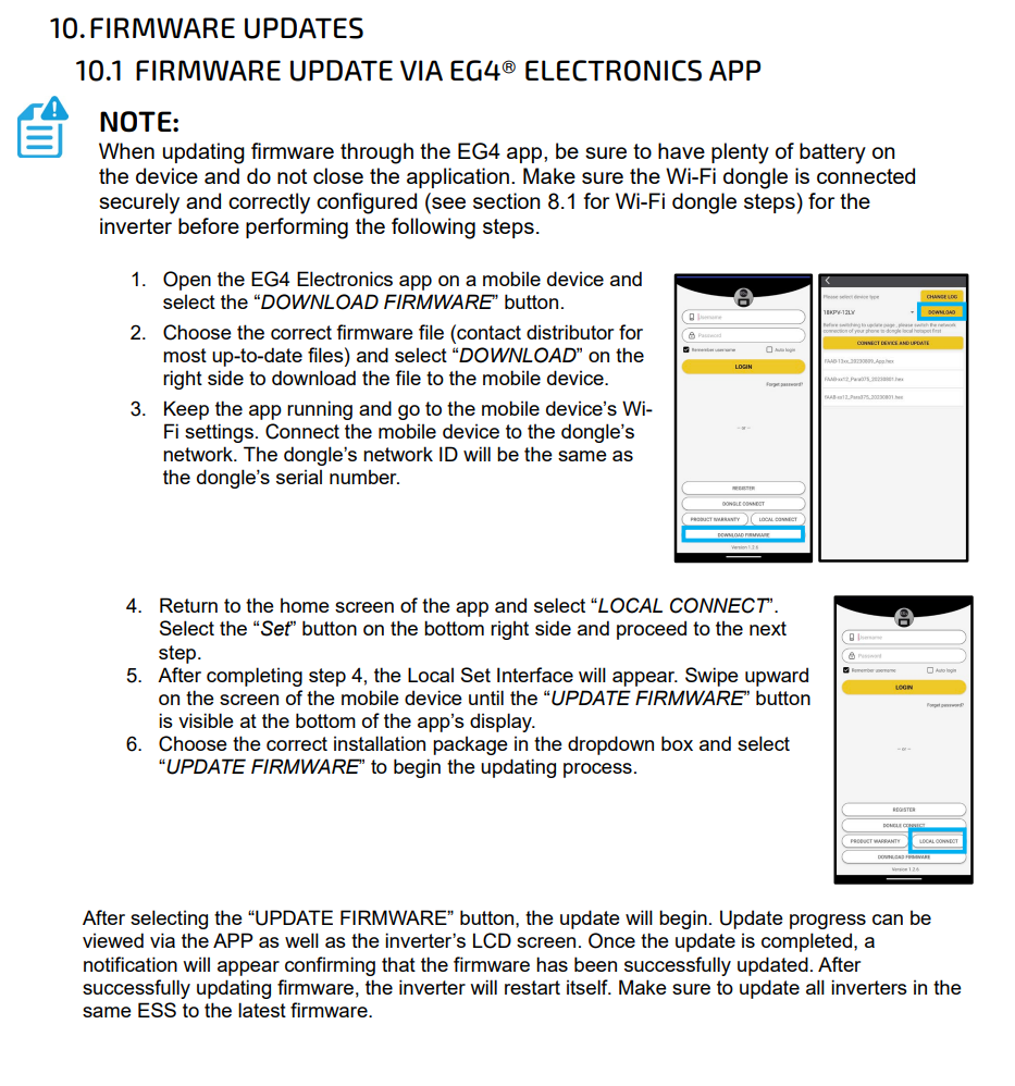

Just out of an abundance of caution, the screenshot instructions you attached largely don't apply since I'm using Bluetooth without an Internet connection. I do not have three lit LEDs on the dongle; I have one flashing green on the wireless icon.

I apologize for the confusion. You are correct.
