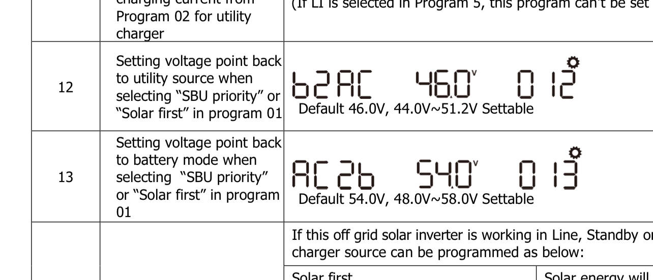

Posted by: @eareyes20
@eg4eric this is no solution AC Charge will have you pay for more grid use. All is needed is a software update that will enable when to go back yo battery more and not the default 10% or 3V. I would prefer to have the system wait until solar is back available and charging to a certain % then go back to battery mode! This is nothing new many inverters have this option like the attached picture from a manual!
