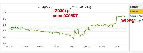

it looks like ceaa-508 introduced a bug, and did NOT include a fix for open-loop lithium charge control. What will be in 509 ? When ?
...I really need to see a fix that results in a LFP-friendly charge for generic open-loop charge control by voltage that results in the desired CC-CV charge curve. I expect to see battery voltage rise to some Vend-of-charge (56-59v), and then relax to Vfloat (53-54v).
firmware is holding battery voltage at vBulk after charge SHOULD end and settle to float. This is not good for batteries, BMS, or safety.
Posted : January 13, 2026 3:27 pm

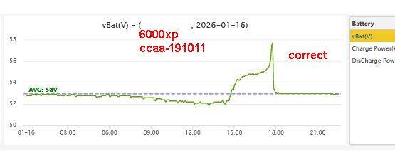

@eg4eric News on fix for charging open loop by voltage ? I'd be happy to test. seems like developers should be able to spot the coding difference between the 6000xp which is working correctly, and the 12000xp which is not ?
260116 6000xp correct Veoc to Vfloat

Any updates on the 12000XP being able to actually move to it's set float voltage?
Posted : June 4, 2026 4:26 pm
(@dtbaker61)
Posts: 153
@solar_pergola firmware ceaa-00080A and later *mostly* fixes the issue. I have notice there are some days with 1 or more quick bounces back up to Bulk, but it mostly settles back down to float ( at 54.0v for me )
