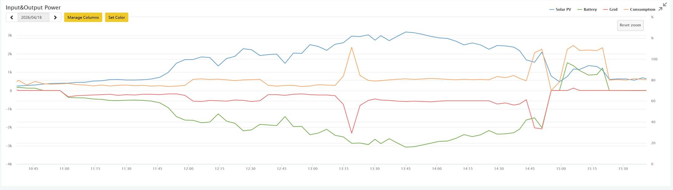

(@jckemp3)
Posts: 27
In the picture below you can see that at 11:00 Grid started to cover consumption. Solar went all to charging battery. This is during my AC Charge time even though I was above my trigger voltage . I do not have PV Charge priority enabled .
ac charge
