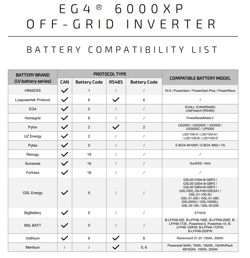

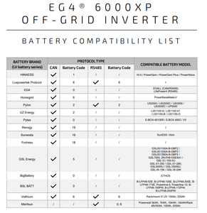

@charlie
Do those batteries support any of the protocols listed in the image?

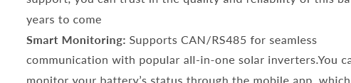

@eg4eric says it supports can and rs485 ?
I'm also interested in these. https://www.eco-worthy.com/products/eco-worthy-51-2v-100ah-lifepo4-lithium-battery-5-12kwh-capacity-server-rack-battery
maybe the battery code needs to be configured on the eg4? or its not connected properly

You can try protocol Lithium 6 (Luxpower) on the inverter and set the protocol to Luxpower on the battery.
Posted : August 13, 2025 9:56 pm
(@goingsolar)
I just recently helped someone with this.  Eco-Worthy Server Rack uses Pylon so use Battery Code 2 (number 6 also works) for your 6000xp.
