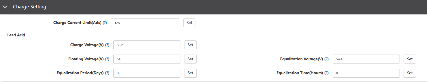

I gave up more testing and run EG4 Wall-mount indoor battery in open loop mode (set up as as Lead Acid type).
It is inconvenient yet it works. A temporary solution until EG4 fixes the BMS firmware and provides tolls to rectify the flaw.

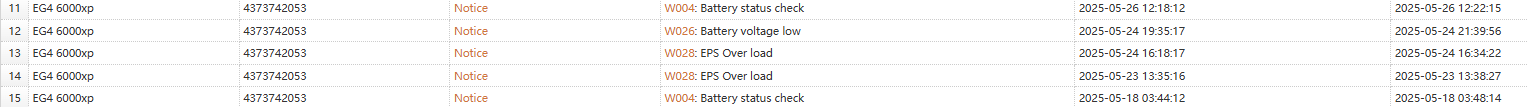

Another bunch of supporting data attached - this is from my previous (RMA-returned May 2025) 6000xp with same Wall Mount EG4 battery.
there was only one instance the EG4 monitoring ap data sampling coincided with the power loss event - line 197 of attached spreadsheet - and the event was recorded (no battery seen bay inverter).
@EG4
Hope some knowledgeable EG4 folks can use that to fix the issue. SS tech were not able to - just issued RMA and I got new inverter with the same problem
Brgds
K

Battery Event Log
Above is the snapshot of Event Log from my replaced 6000p indicating when the Wall Mount Battery BMS problems started. As mentioned before the 6000xp was RMA replaced in June 2025 and the problem persist. The returned inverter was bench tested by EG4 and found fully operational (as per SS tech support).
I am waiting on EG4/SS response to provide RS232/USB kit to check/upgrade that BMS firmware before I decide to attempt to switch back to Lithium battery type
Brgds
K

My charge setting are set up accordingly - Its not ideal, but works
