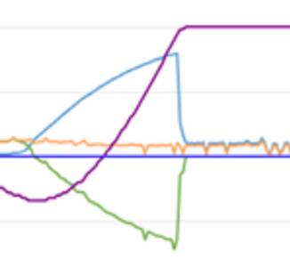

Looks like you have enough solar but you cant use it all with your loads at the time that your solar is producing. Your battery gets charged up and cant store any more power, at that point the remaining of your solar has no where to go other than the small loads at that time. Basically you need more battery storage to capture the extra energy that is not being used. That additional storage will then carry you through times when no solar is present. I would say that you could make use of at least one more 14.4KWh battery or possibly more. This would need to be evaluated for your system. The data page will help in evaluating what you need.
Below shows a snip of your data that shows the solar charging your battery to 100% and appears to be finished charging in ~4 hours. Another battery would allow you to capture that remaining solar during the day that currently is not being used or captured.

@fkitzmann & @montufar
You are both correct!  A second battery was required!   You will find the results of adding that battery here ==> https://forum.eg4electronics.com/community/share-your-setup/north-central-texas-setup-just-about-to-turn-a-year-old/paged/2/#post-15497
Thanks & keep looking up!
