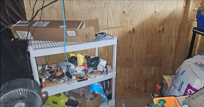

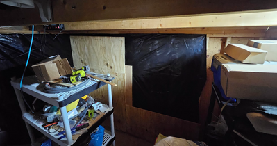

An update on the insulation project. I have finished putting in the insulation, the vapor barrier covered by 1/2in plywood.  I have completed the entire east end (except the ceiling).   Paint and double sided reflecting film with 5mm foam insulation happen this weekend (arthritis not acting a fool).  Stand-by.
