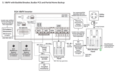

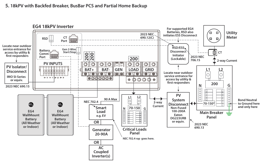

I'm looking for a best practices document or guidance re using the Gen port for Smart Load.  I'm considering using it for a sub panel in my garage for EV Charging (40A max).  Thank you in advance for any advice on this topic.
8 Replies
Posts: 1303
Are you asking for something like this?
BobAndRoslyn
(@bobandroslyn)
Posts: 99
@eg4eric Thanks, Eric.  That is better than I found.  I dont see a breaker in between the lugs and the "Smart Load", but I assume one would be needed?  Also, please confirm the Max Amperage is 90amp.  Finally, see the follow up questions below regarding "Grid Always On" setting.
Posts: 1303
@bobandroslyn
You can use up to a 90A breaker. However, I’m unable to confirm the electrical wiring requirements or whether an additional breaker is required between the lugs and the Smart Load since I am not a licensed electrician, but I can look for a better wiring diagram.
