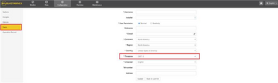

Currently, a manual adjustment is required to switch from Daylight Saving Time to Standard Time. This can be done by navigating to the Configuration tab > Stations > Station Management.

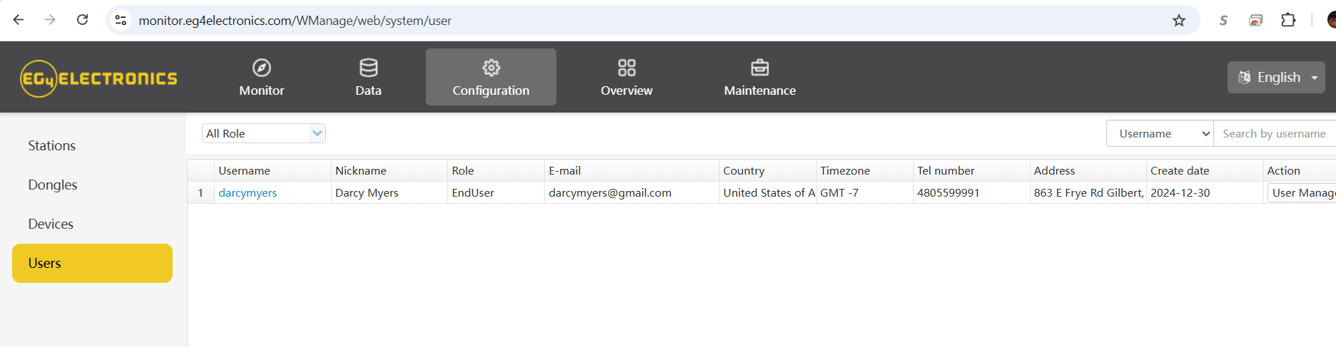

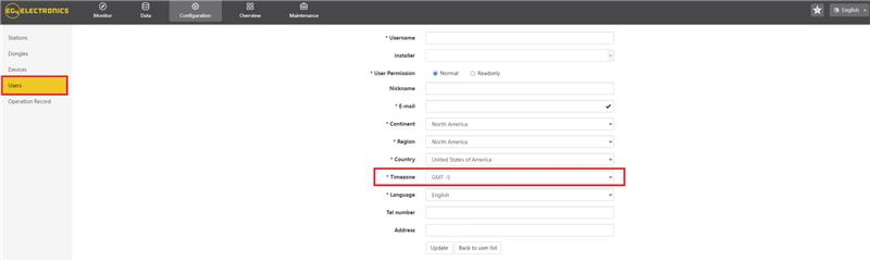

@darcymyers We believe the issue has been resolved. I would recommend checking that the station and end-user times are set to the same GMT.
(@darcymyers)
Posts: 8
@jared I will absolutely check that as soon as I have time to log in but I'm not sure it will be helpful as the problem is not the time the problem is the daylight savings button being turned off and then it automatically turning itself back on within an hour or two.

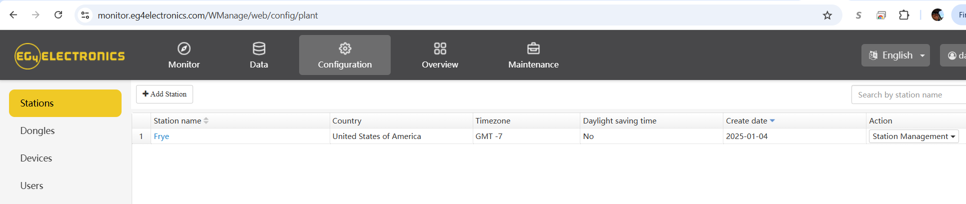

(@darcymyers)
Posts: 8

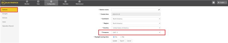

@jared here you go, both are set and the same.  in an hour when the daylight savings turns its self back to YES from NO i'll screenshot it again.
user matching time zone
station time zone and daylight savings NO

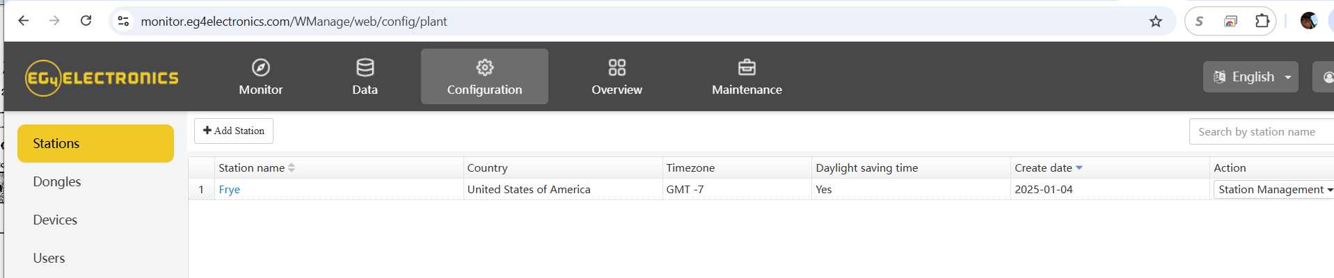

(@darcymyers)
Posts: 8
@jared nevermind it only took 3 minutes and it already reset back to daylight savings YES.
station time zone and daylight savings YES
Jared
(@jared)
Posts: 261
@darcymyers the server will take up to 5 minutes for the command to stick. However, is it still currently set to DST? The station is showing "NO" on my end.
(@darcymyers)
Posts: 8
@jared unfortunatley it is still defaulting back to YES for Daylight Savings.  would be great if this were fixed but i give up for now.  i cant risk the $200 demand fees from SRP they are pure evil, i hate them and i cant let them win.  i'll just set my battery to run 1 hour early and 1 hour late so whatever it decides to switch to in the future i'll be covered.
