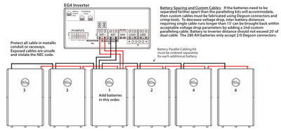

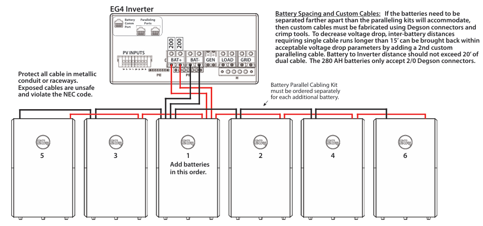

I have a grid boss with a 90amp breaker and one flex boss 21. I am currently have 3, 14.3 kWh outdoor batteries installed.  I am looking to add additional batteries to my system but have been getting conflicting information. How many can I add without needing another inverter or a special external buss?
Does the breaker in the grid boss have any limitations on the number of batteries?
@walker
You can connect up to 6 in parallel before needing external bus bars.
Does the breaker in the grid boss have any limitations on the number of batteries? No, the inverter is equipped with a DC breaker between the battery and the inverter.
