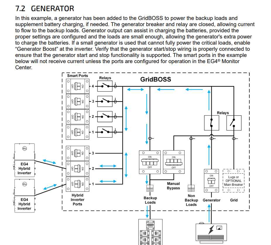

I'm looking into getting a GridBoss and trying to learn about the settings available with it.  If I have a battery backup and a generator, in the event of loss of grid power, is the GridBoss able to utilize the backup battery until it reaches a specified SOC or period of time and after that activate the generator?
Posts: 1285
Yes, if grid goes down, your system will use battery power for loads and once they hit that percentage or voltage that is set, the generator will take over in powering loads and will charge the batteries.
